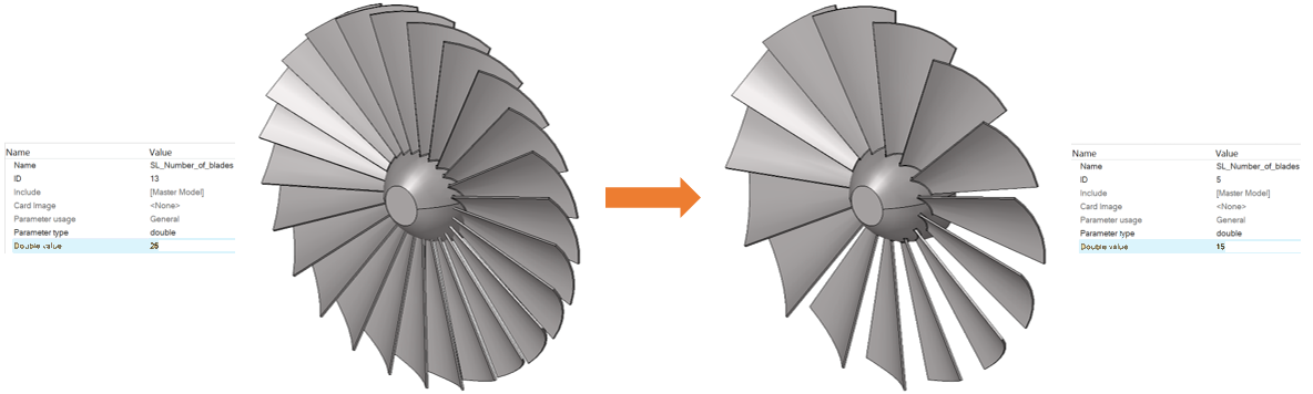

Live Parameter Update
If you set the preference to allow immediate updates, changing any relevant parameter values (from within EE, via a script, and so forth) will immediately execute the update operation. If the CATIA/NX update operation is successful, the original CATIA/NX file is overwritten and parts associated with the modified parameter are purged and reloaded.
Delayed Parameter Update
If you set the preference to not allow immediate updates, changing any relevant parameter values (from within EE, via a script, and so forth) will not execute the update operation. Instead, you can use the CAD update tool to update parameters when necessary.
Results
