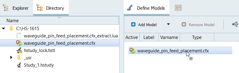

Add a FEKO model by dragging-and-dropping the
waveguide_pin_feed_placement.cfx from the Directory
into the work area.
The Resource, Solver input file, and Solver input arguments fields become populated.
Figure 1. -

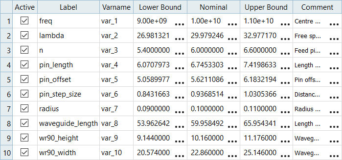

Click Import Variables.
Ten input variables are imported from the waveguide_pin_feed_placement.cfx file.
- Go to the Define Input Variables step.
Review the input variables.

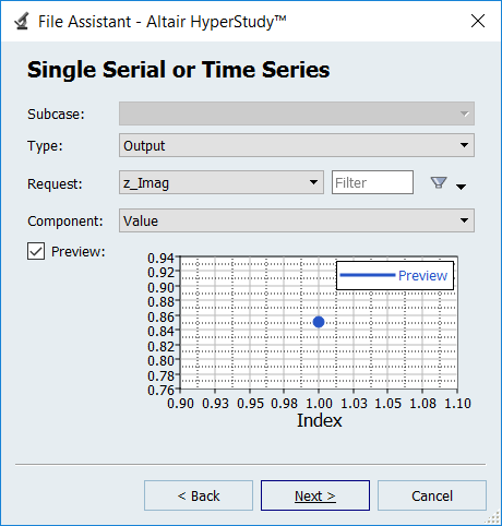

- Select Altair® HyperWorks® (HstReaderPdd) and click Next.
- Select Single Item in a Time Series and click Next.
Define the following and click Next.
- Set Type to Output.
- Set Request to z_Imag.
- Set Component to Value.

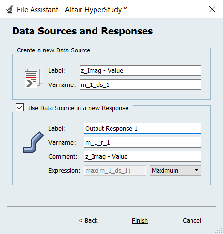

Figure 3. - Enter labels for the data source and output response.
- Set the output response Expression to Maximum.
Click Finish.

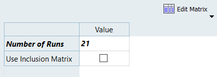

- In the work area, set the Mode to Hammersley.
In the Settings tab, change the Number of runs to
21.
Figure 5. - Click Apply.

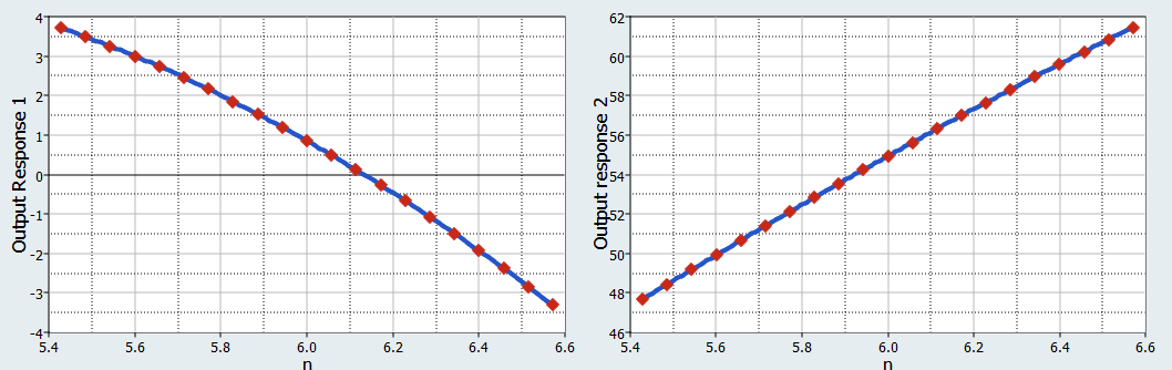

Plot the response surface.
- Click the Trade-Off tab.
- Using the Channel selector, select both output responses.
- From the Inputs section, select the X Axis checkbox.
From the Output Plots section, select
(Multiplot).
Figure 8.
