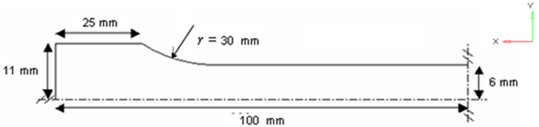

A quarter of a standard tensile test specimen is modeled using symmetry conditions. A traction is applied to a specimen via an imposed velocity at the left-end.
The units are: mm, ms, g, N, MPa.
Figure 1. Geometry of the Tensile Specimen (One Quarter of the Specimen is Modeled)

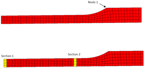

Figure 2. Sections of Node Saved for Time History

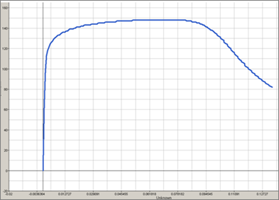

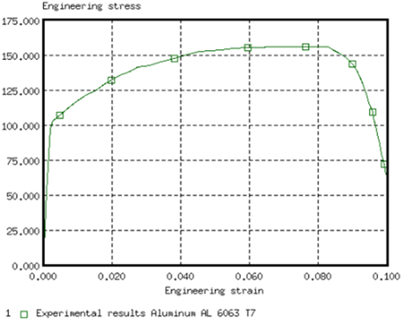

Figure 3. Engineering Stress Versus Engineering Strain Curve (Experimental Data)
For the simulation results, engineering strains will be obtained by dividing the displacement of node 1 by the reference length (75 mm), and engineering stresses will be obtained by dividing the force in section 1 by its initial surface (10.2 mm2).

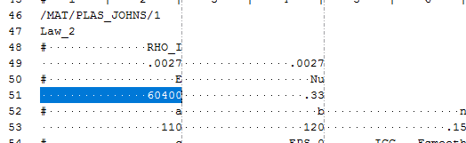

  4. In the Find area, enter /MAT/PLAS_JOHNS/1 and click .
    HyperStudy highlights /MAT/PLAS_JOHNS/1.
    Figure 5.
  5. Select variable E by highlighting the first 20 fields in row 51.
    Tip: Quickly highlight 20-character fields by pressing Ctrl to activate the Selector (set to 20 characters) and then clicking the value.
    Figure 6.

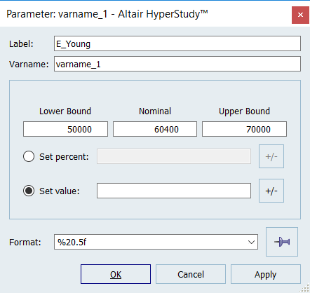

  6. Right-click on the highlighted fields and select Create Parameter from the context menu.
  7. In the Parameter: varname_1 dialog, define the following options and click OK.
    1. In the Label field, enter E_Young.
    2. Change the Lower Bound to 50000.
    3. Change the Nominal value to 60400.
    4. Change the Upper Bound to 70000.
    5. Change the Format to %20.5f.

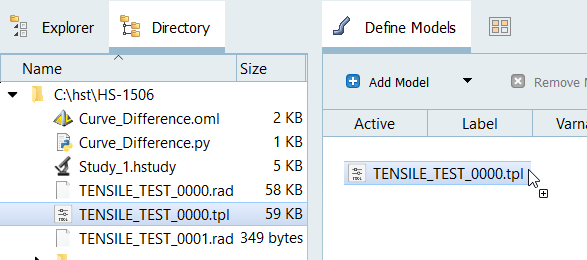

  4. Add a Parameterized File model.
    1. From the Directory, drag-and-drop the TENSILE_TEST_0000.tpl file into the work area.
      Figure 8.
    2. In the Solver input file column, enter TENSILE_TEST_0000.rad.

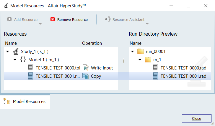

  5. Define a model dependency.
    1. Click Model Resources.
    2. In the Model Resource dialog, select Model 1 (m_1).
    3. Click Resource Assistant > Add File.
    4. In the Select File dialog, navigate to your working directory and open the TENSILE_TEST_0001.rad file.
    5. Set Operation to Copy.
    6. Click Close.
    Figure 9.

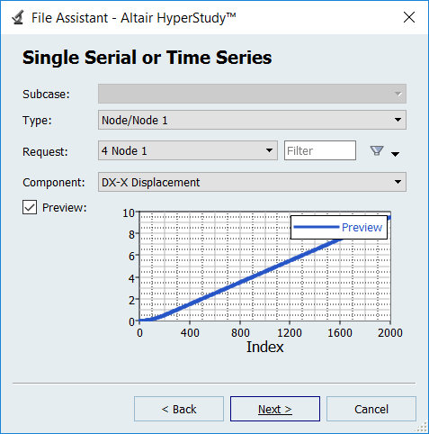

  2. Create a data source labeled Disp_sim.
    1. From the Directory, drag-and-drop the TENSILE_TEST01 file, located in approaches/setup_1-def/run__00001/m_1, into the work area.
    2. In the File Assistant dialog, set the Reading technology to Altair® HyperWorks® and click Next.
    3. Select Single Item in a Time Series, then click Next.
    4. Define the following options, then click Next.
      • Set Type to None/Node 1.
      • Set Request to 4 Node 1.
      • Set Component to DX-X Displacement.
      Figure 11.

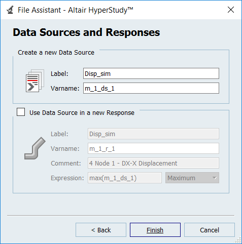

    5. Under Creating a new Data Source, enter Disp_sim in the Label field.
    6. Clear the Use Data Source in a new Response checkbox.
    7. Click Finish.
      Figure 12.

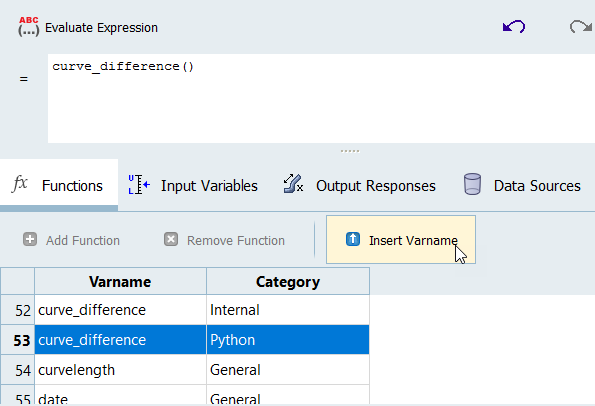

    1. In the Expression Builder, click the Functions tab.
    2. From the list of available functions, select curve_difference.
    3. Click Insert Varname.
      The function curve_difference() appears in the Evaluate Expression field.

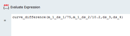

      Figure 13.
    4. In the Evaluate Expression field, edit the expression so that it reads curve_difference(m_1_ds_1/75,m_1_ds_2/10.2,ds_3,ds_4).
      Note: In the expression, you will notice that the four data sources are entered differently. The varname for the first two data sources created using the File Assistant are labeled as m_1_ds_#, whereas the varname for the last two data sources created in the Expression Builder are labeled as ds_#.
      The displacements and forces are read from the simulation, whereas from the experiment you have strains and stresses. In order to convert the displacement and forces to strains and stresses, you need to divide the displacements by the length (75) and forces by the area (10.2).
      Figure 14.

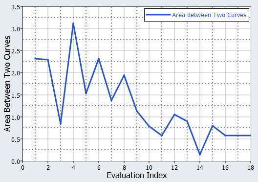

  10. Click the Evaluation Plot tab to plot the optimization iteration history of the objective.
    Figure 16.
