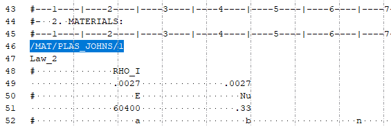

Create Base Input Template
In this step, you can create the base input template in HyperStudy or use the base input template in the study Directory.

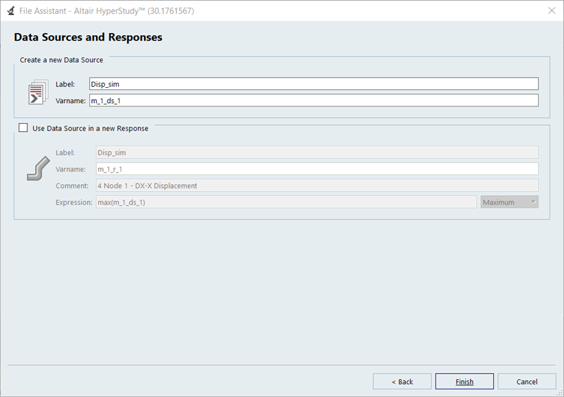

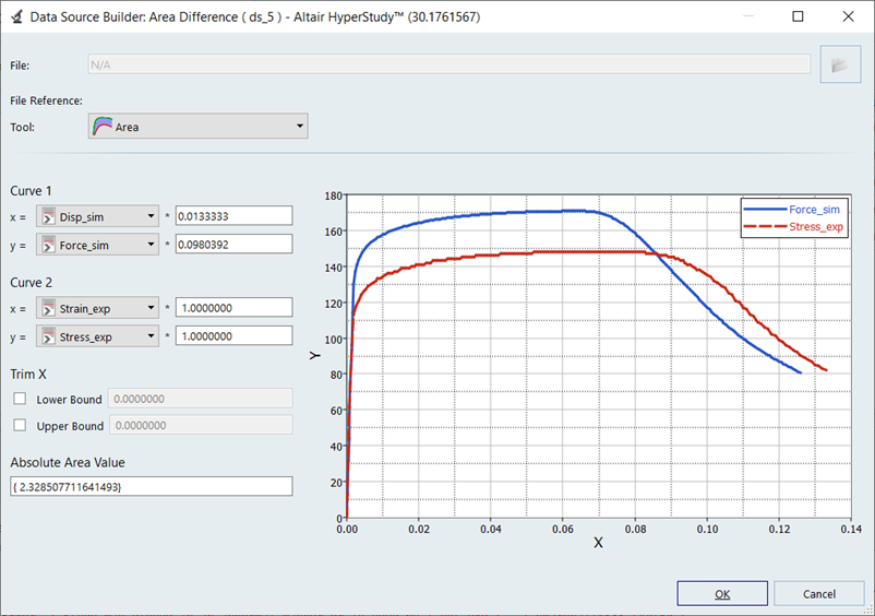

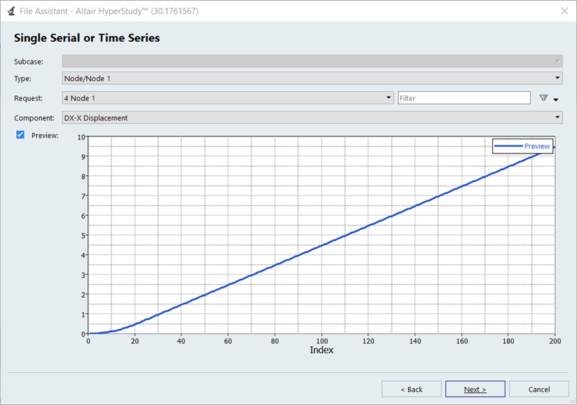

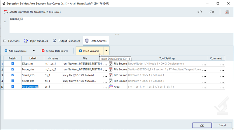

Create and Evaluate Output Responses
In this step, you will create the data sources to be used in the Area function and evaluate output responses.
