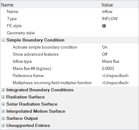

The geometry for this problem consists of a simple pipe channel with perfectly circular cross-section as the base shape. Water enters the Inlet at the rate of 0.0003 kg/s and the outlet is a standard pressure outlet at zero relative pressure. Walls of the channel are no-slip walls.

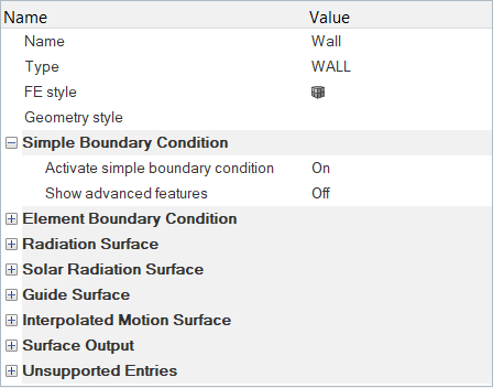

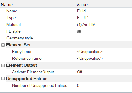

By default, all components are assigned to the wall boundary condition. In this step, you will change them to the appropriate boundary conditions and assign material properties to the fluid volumes.

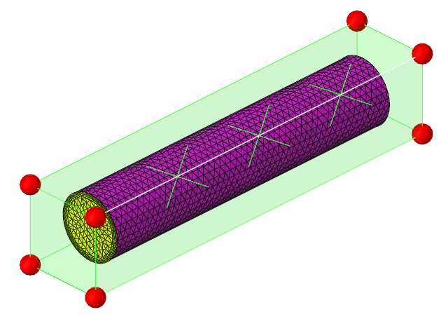

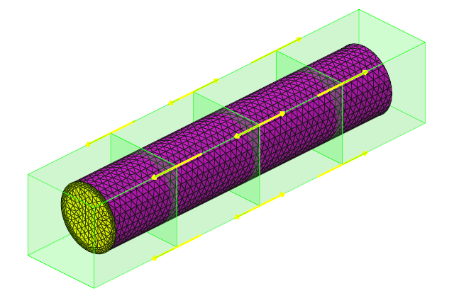

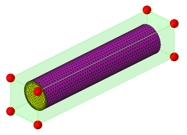

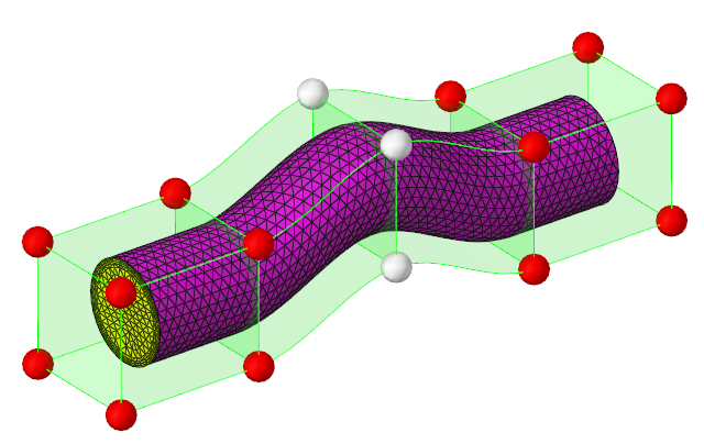

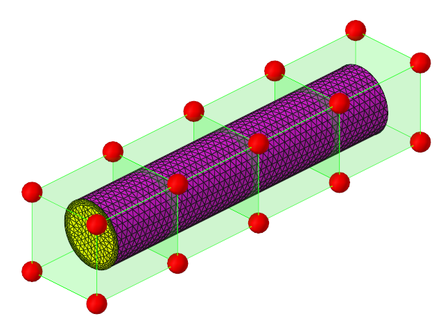

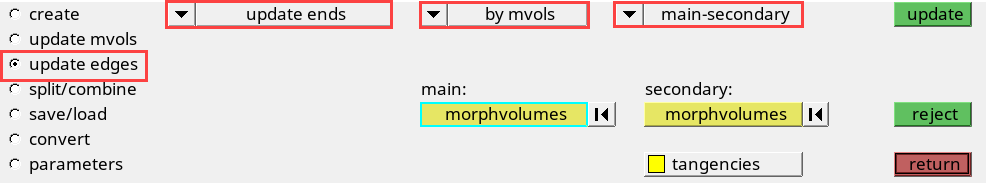

Generate and Export Morph Shapes

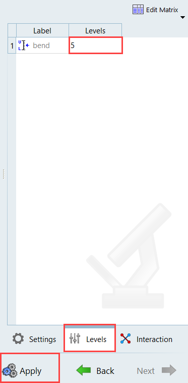

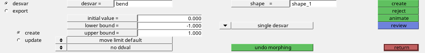

Define the Design Variable

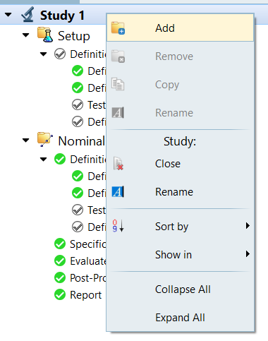

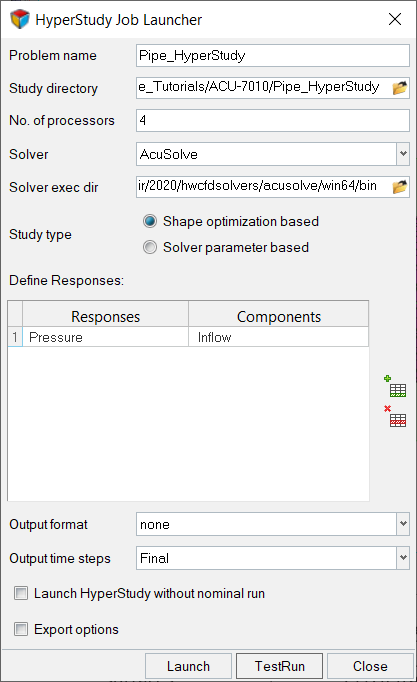

Launch the DOE Study Using HyperStudy
Start the Nominal Run
In the HyperStudy window, check step by step by clicking on each setup from the Explorer menu to ensure that everything was properly defined.

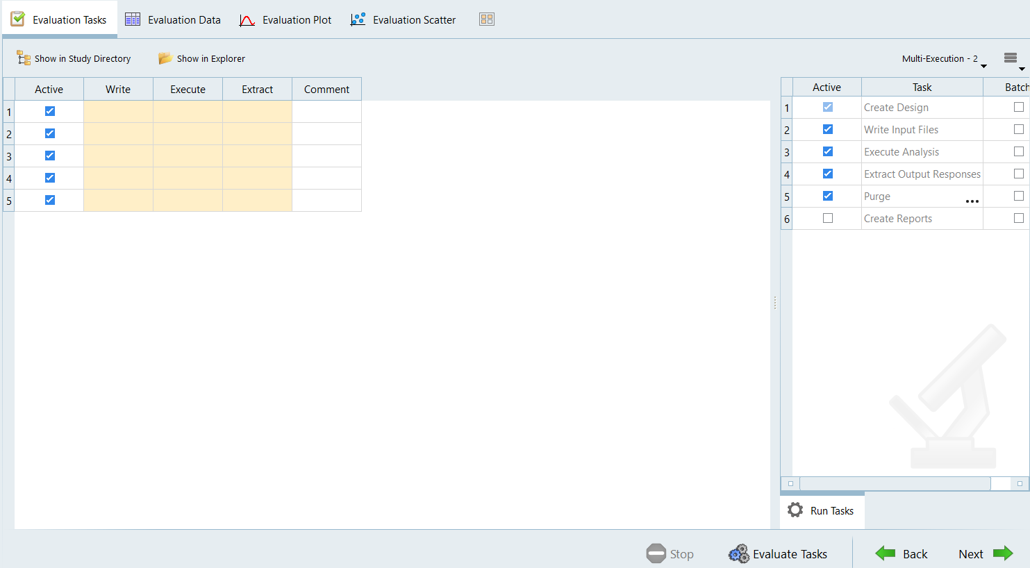

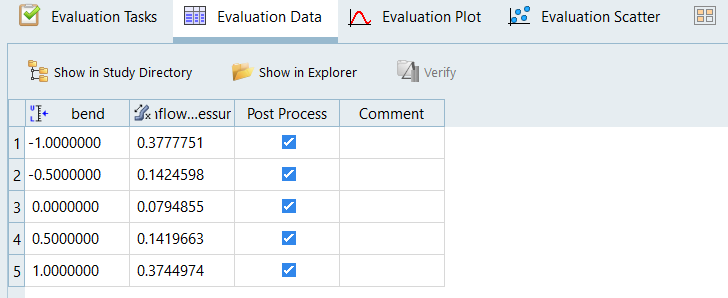

Run the DOE Study

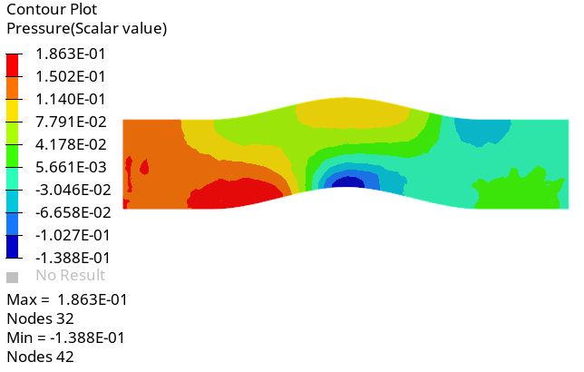

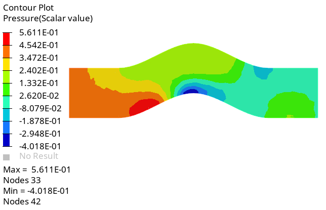

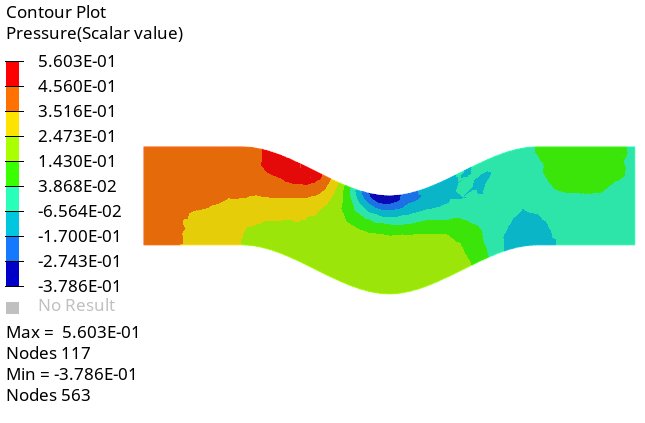

Create a Pressure Contour on a Cut Plane

This tutorial introduced you to running a DOE study using Altair products, namely HyperMesh, AcuSolve, HyperStudy and HyperView. You started by importing a HyperMesh database and then set up the simulation parameters for AcuSolve and created a morph shape using HyperMorph. Next, you set up the design variable and linked the morph shape to it. Then, you proceeded to set up the DOE study. Once the results were obtained, you processed the results using HyperView.
