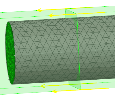

The geometry for this problem consists of a simple pipe channel with perfectly circular cross-section as the base shape. Water enters the Inlet at the rate of 0.0003 kg/s and the outlet is a standard pressure outlet at zero relative pressure. Walls of the channel are no-slip walls.

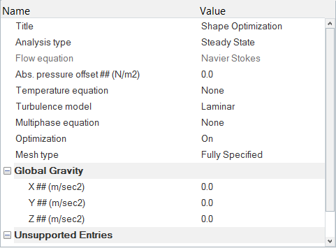

Set the Global Simulation Parameters
Set the Analysis Parameters

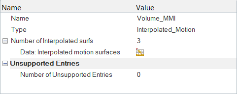

Create Mesh Motion

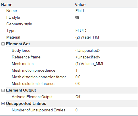

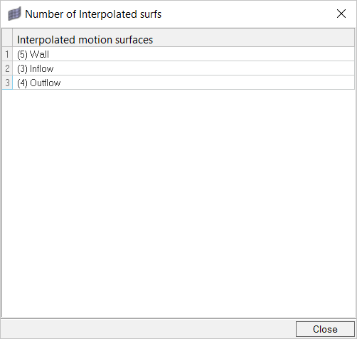

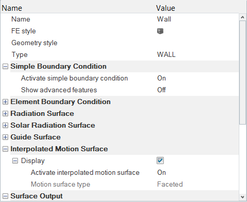

An optimization study can be performed in AcuSolve using either volume morph shapes or surface morph shapes. If volume morph shapes are used for simulation, you do not need to define mesh motion, as the volume nodes will move using the input from morph shapes. If surface morph shapes are used for simulation, interpolated mesh motion is needed to define the motion of volume nodes in the model. For this tutorial, surface morph shapes with interpolated mesh motion is used.

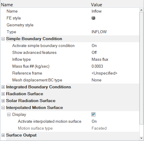

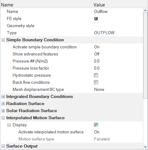

Specify the Boundary Conditions and Material Models Parameters

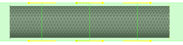

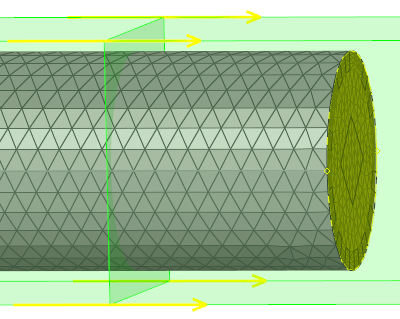

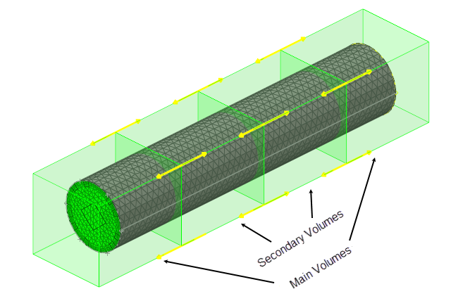

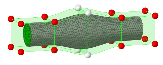

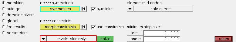

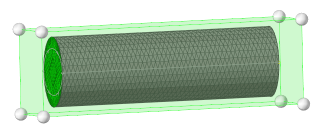

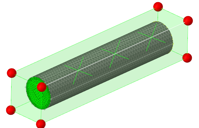

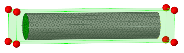

HyperMorph is used to parameterize the shape of the design. You will create morph shapes by moving the surface nodes. The volume nodes will be taken care of using the interpolated mesh motion feature of HyperMesh.

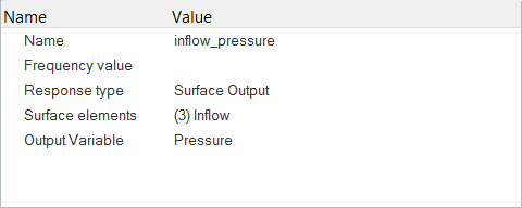

Define the Response Variable

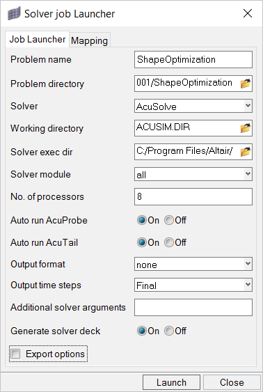

In this step, you will launch AcuSolve directly from HyperMesh and compute the solution.
Run AcuSolve

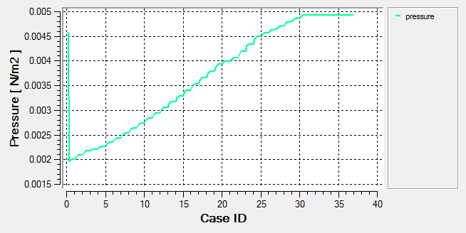

AcuProbe can be used to monitor various variables over solution time. An AcuProbe window will be launched by the Solver Job Launcher if the Auto run AcuProbe flag is set to On.

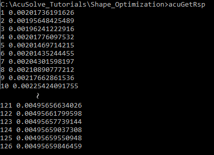

AcuGetDv and AcuGetRsp

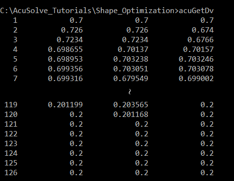

AcuSolve provides two post-processing utilities specific to optimization problems, AcuGetDv and AcuGetRsp. AcuGetDv provides the values of the design variables for all the cases included in the solution. AcuGetRsp provides the values of the response variables for all the cases included in the solution.
