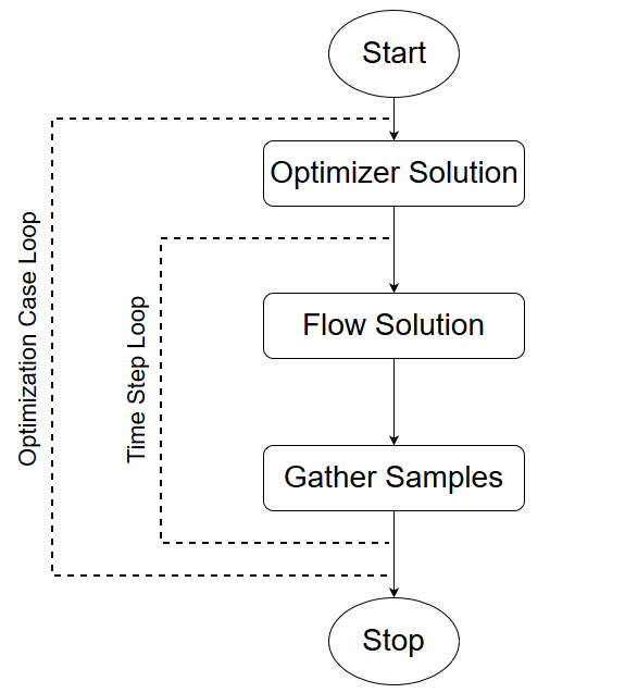

Optimization Solution Sequence
The design optimization may be considered as a sequence of cases, where each case first runs the optimizer and updates the design variables and then solves the flow equations for a number of time steps until convergence. Sample data is gathered at the end of each time step.
- Constructing the response surface from the set of samples.
- Running the optimizer on the response surface.
- Updating the design variables.

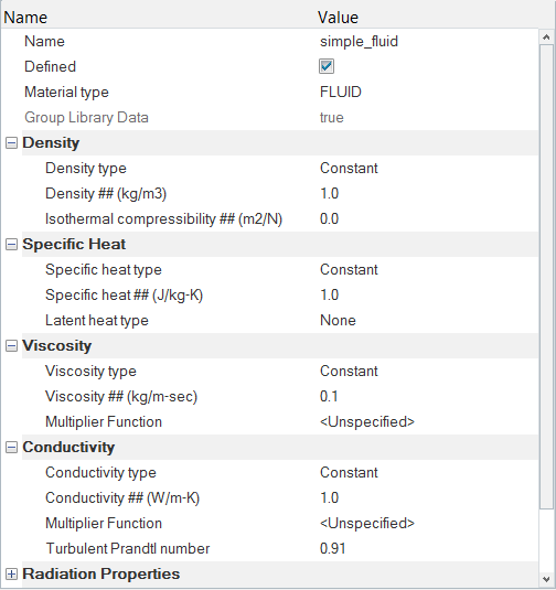

Set Material Model Parameters
In the next steps, you will create a new custom material and assign relevant material properties to it.

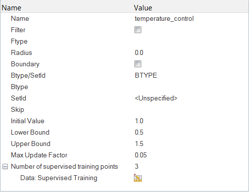

Define the Design Variable

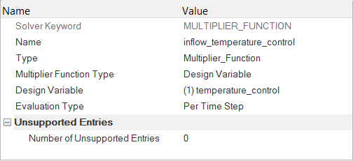

Create a Multiplier Function for the Design Variable
In HyperMesh, multiplier functions are used to scale values of certain parameters at runtime. For example, viscosity of a fluid may vary with temperature. Or inflow rate or temperature may vary over time.
Multiplier functions can also be used to scale the values of the design variables between cases. In quantity optimization, the design variables are linked with the desired quantities in HyperMesh through multiplier functions.

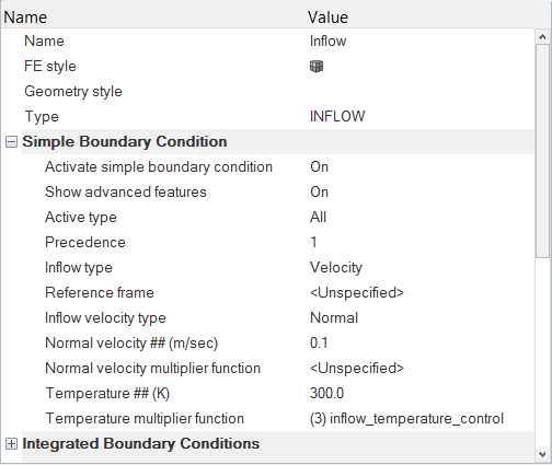

Assign Boundary Conditions and Material Properties

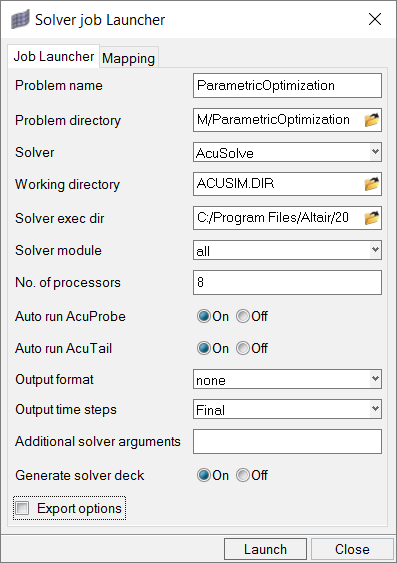

Run HyperMesh
In this step, you will launch AcuSolve directly from HyperMesh and compute the solution.

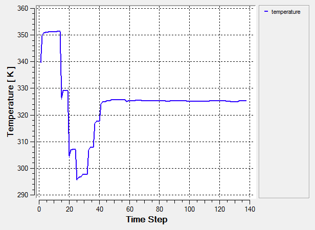

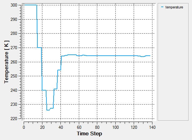

Monitor the Solution with AcuProbe
AcuProbe can be used to monitor various variables over solution time. An AcuProbe window will be launched by the Solver Job Launcher if the Auto run AcuProbe flag is set to On.

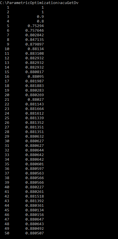

AcuGetDv and AcuGetRsp
AcuSolve provides two post-processing utilities specific to optimization problems, AcuGetDv and AcuGetRsp. AcuGetDv provides the values of the design variables for all the cases included in the solution. AcuGetRsp provides the values of the response variables for all the cases included in the solution.
