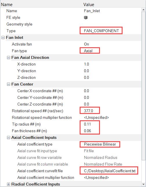

The problem to be solved in this tutorial is shown schematically in the figure below. It consists of an interior fan which rotates at a speed of 377 rad/sec (~3600 RPM) and has a thickness of 0.06 m and a tip radius of 0.11 m. The volumetric flow rate at the inlet is 0.146 m3/sec (~525.35 m3/hr). The problem is simulated as a steady state run and the pressure rise across the fan region is computed.

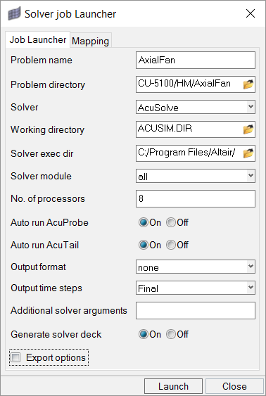

In this step, you will launch AcuSolve directly from HyperMesh and compute the solution.
Run AcuSolve

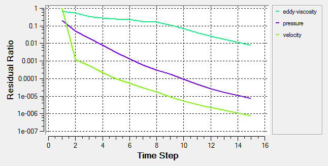

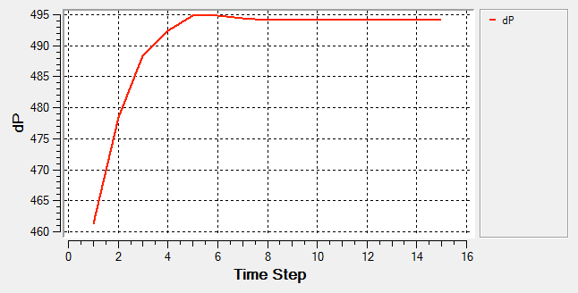

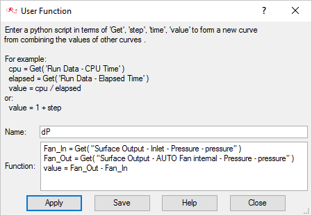

As the solution progresses, the AcuProbe window is launched automatically. AcuProbe can be used to monitor various variables over solution time.
Summary

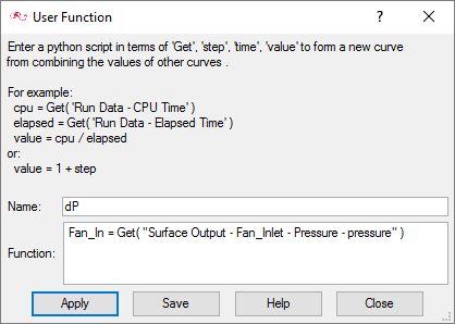

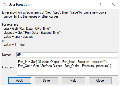

In this tutorial you successfully learned how to set up and solve a simulation involving a fan component. You imported the meshed geometry and then assigned the material properties and boundary conditions to all the regions. Once the solution was computed, you defined a user function to create a plot of the pressure rise across the fan component volume.
