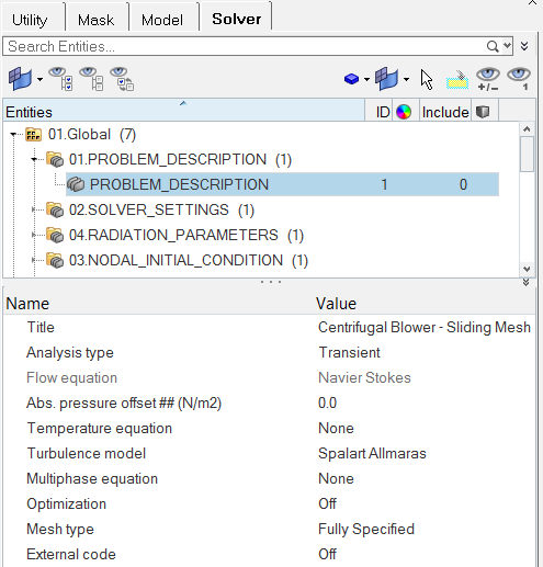

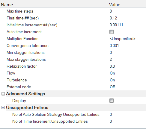

Set the Transient Simulation Parameters
Specify the Solver Settings

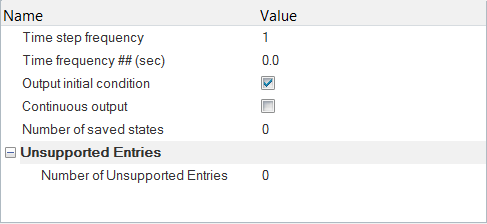

Set the Nodal Output Frequency

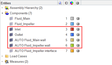

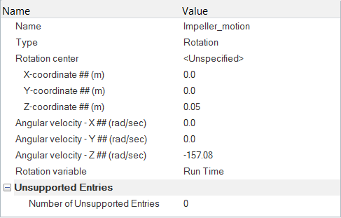

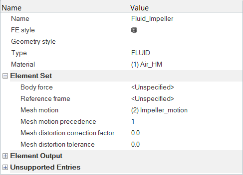

Define Mesh Motion and Set Up Boundary Conditions
Create Mesh Motion
Modify the Boundary Conditions

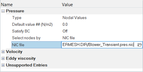

Specify the Nodal Initial Conditions

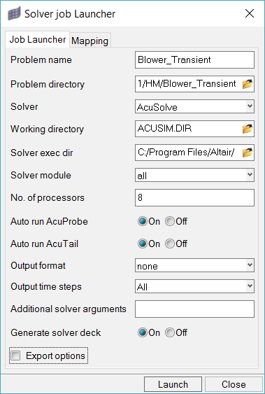

Compute the Solution

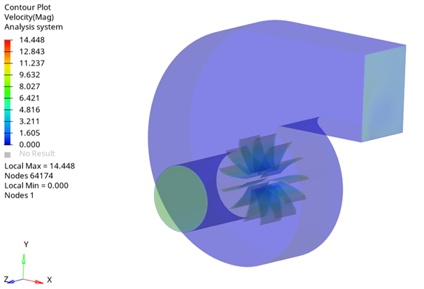

Post-Process the Results with HyperView
Open HyperView and Load the Model and Results

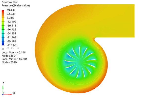

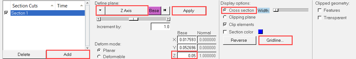

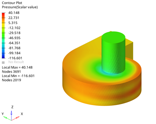

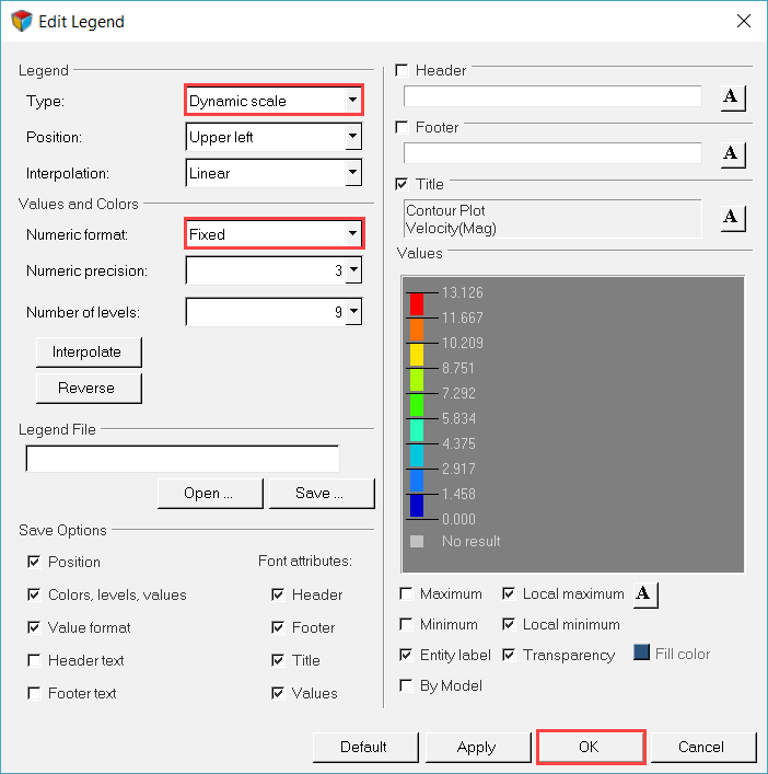

Create a Pressure Animation

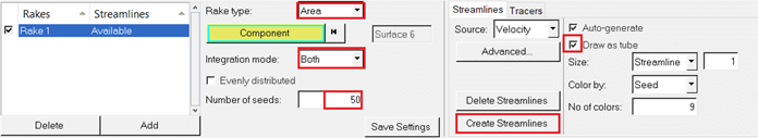

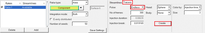

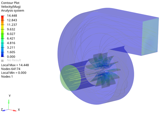

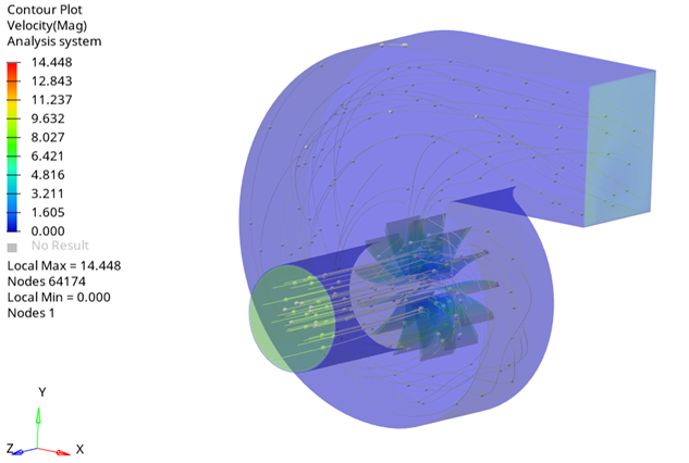

Create Streamlines
