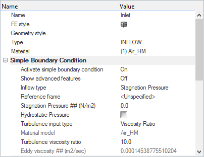

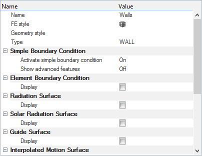

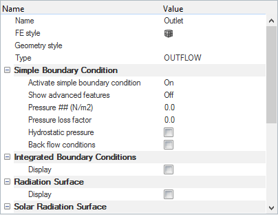

Set Up Boundary Conditions and Material Model Parameters

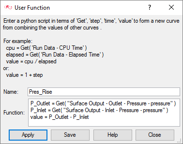

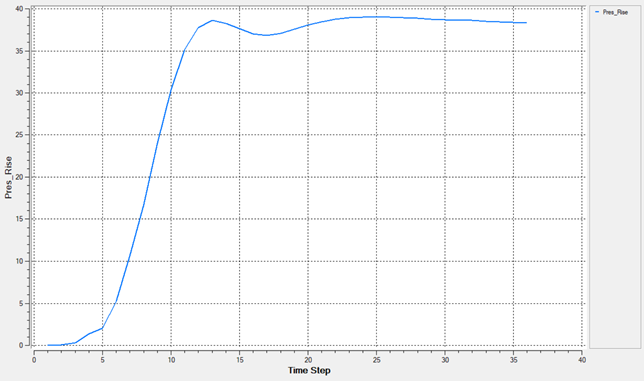

As the solution progresses, the AcuTail and AcuProbe windows are launched automatically. In this step, you will create a User Defined Function (UDF) and generate a plot of the pressure rise between the inlet and outlet.

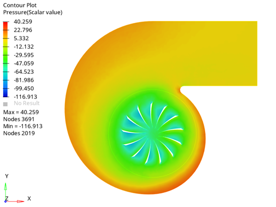

Create a Pressure Contour on a Section Cut Plane
