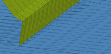

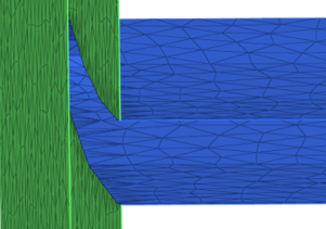

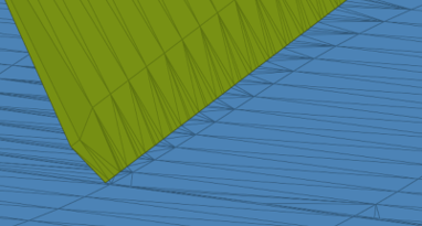

| Keep Interface | Select this checkbox to keep common shells between source and target
as they are. Uncheck to remove common shells.![]() Figure 1. Keep Interface Enabled ![]() Figure 2. Keep Interface Disabled |

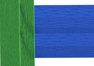

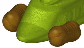

| Collapse Patches | Select this checkbox to collapse created patches and directly connect
the source nodes to the target nodes. When enabled, you can select a
destination component for patch: Source Component, Current Component, or
New Component. ![]() Figure 3. Collapse Patches Enabled ![]() Figure 4. Collapse Patches Disabled |

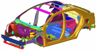

CFD Fluid Analysis Model Preparation
Figure 5.

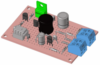

Thermal Analysis Model Preparation
Figure 6.
