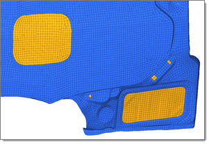

Figure 6. Gap Filled between Element Sets - Choose Patch fills to fill partial edge loops;
fills gaps and holes as a pre step for wrapper, where a non-conformal patch
can be created to provide a proper input to wrapper.
Figure 7. Partial Edge Loop
Figure 8. Partial Edge Loop Filled
Figure 9. Gaps and Holes
Figure 10. Gaps and Holes Filled (Non-Conformal Patch)

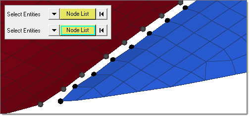

For gaps use the first selector to select entities along one side of the gap, then use the second selector to select entities along the other side of the gap.Note: Selection options change based on the Fill Mode selected.
Figure 11. Node Lists to Detect the Gap -

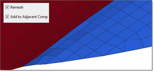

- Click Fill.
Figure 12. Gap F and Remeshed with Adjacent Components
