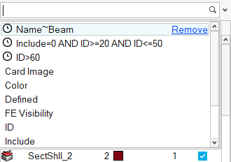

Access Recent Search Strings
Click the text field of a browser search bar.
Your recent searches are indicated by the icon.
Figure 4.
Clicking on a recent search string auto-applies the filter and shows the search string in the search bar.
Clicking Remove removes the selected search string from recent history.
Note: A maximum of 5 recent searches are shown. Remove the latest strings to see previous search strings.
