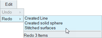

- Undo an action by clicking from the menu bar, or pressing Ctrl+Z.
- Redo an action by clicking from the menu bar, or pressing Ctrl+Y.
