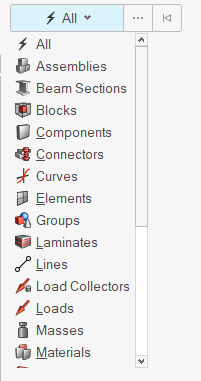

Entity Selectors
Use entity selectors to specify which type of entity you are able to select.
Entity selectors act as a filter by limiting your selection to a single entity type in the modeling window. For example, if an entity selector is set to Surfaces, only surface are available for selection. If it is set to Points, you can draw a window around the entire model and only the points will be selected. After performing a selection, the number of selected entities appears in parenthesis.
If a selector supports multiple entity types, click the arrow to view a drop-down menu of available options.
Entity selectors do not affect your selection in a browser. The entity selector in the modeling window will automatically update to match the selected entity type. You're also able to select multiple entities of different types in a browser.
When working in a panel, the above selectors are disabled and the yellow panel selectors take precedence.

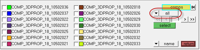

Select Entities From a Panel
When working in a panel, selection is performed via yellow entity selectors.
The yellow entity selectors allow you to indicate which entities are to be modified when a function is performed in a panel. Their behavior is similar to the entity selectors elsewhere in the application.
Figure 7. Entity Selector
To change the data type, click the entity selector switch to access the pop-up menu of possible data types and select the type you want to use.
In addition to selecting one entity at a time on the screen, you can select multiple entities via quick window selection.
Figure 8. Extended Entity Selection Window
These selection options display for all of the entity types supported in the active client. Selections that are not valid for the current entity type are grayed out.
If you want to reset the entity selections, click the reset button to deselect all selected entities.
If the data type is a line list, click the data type of the entity selector to see the selected entities in the order in which they were selected.

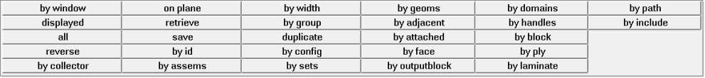

Extended Entity Selection Menu
The extended entity selection menu provides a number of entity selection options.
