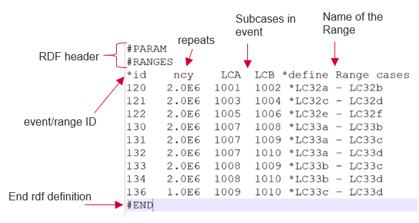

Import and Export Range Definition Files
Range definition files (*.rdf) help create fixed range events automatically.
The LCF is used to create the derived loadcases, which are then used to define fixed ranges via the RDF.
#PARAM and should contain the following data in the sequence
mentioned below:- A
#RANGEStag to indicate the start of the definition of the ranges. - Range detail with the id, lower limit, upper limit, and the range name, as shown in the example below.
Figure 3. Example Range Definition File
