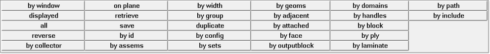

Extended Entity Selection Menu
The extended entity selection menu provides a number of entity selection options.

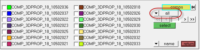

Card Filter
Use the Card Filter to restrict the list of entities displayed when you click the entity selector.
Figure 6. Card Filter. Card Filter is outlined in red.
