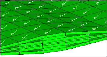

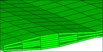

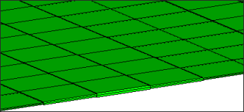

Figure 1. Layers Off

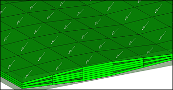

Figure 2. Composite Layers

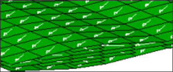

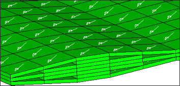

Figure 3. Layers with Fiber Direction - 2D Detailed Element Representation (

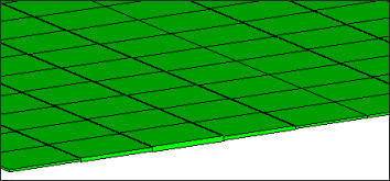

Figure 4. Layers Off

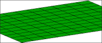

Figure 5. Composite Layers

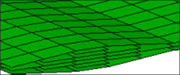

Figure 6. Layers with Fiber Direction - 2D Traditional and Detailed Element
