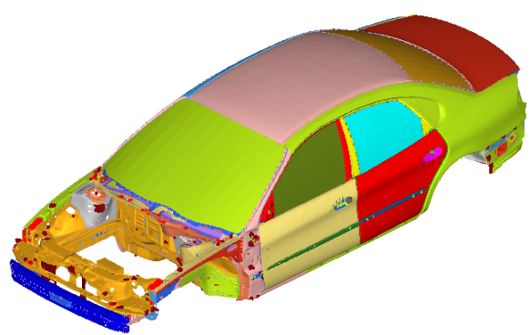

Open the Model

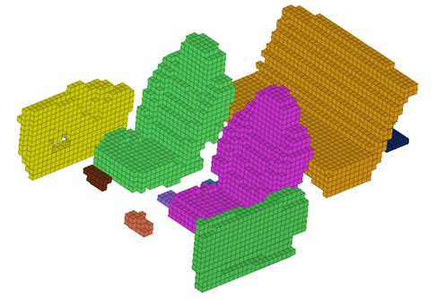

Hide the Seat Cushion Components
Set the Options for Creating Acoustic Cavity Mesh
The imported model has been restricted to just those parts that will be used to create the cavity. The seat cavities have already been built in this model.

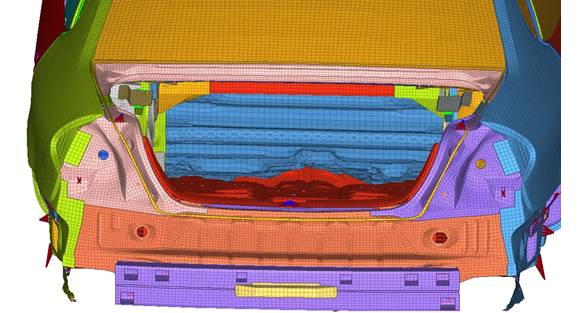

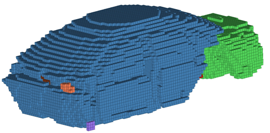

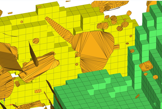

Preview the Mesh
Review the Mesh

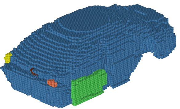

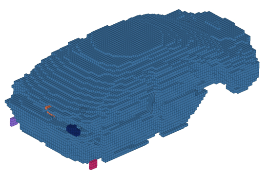

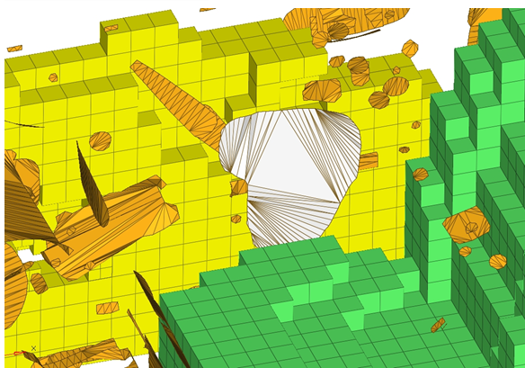

Delete Two of the Patched Holes

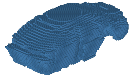

Preview the Mesh
With the patched holes deleted, the acoustic cavity mesh will be previewed again.

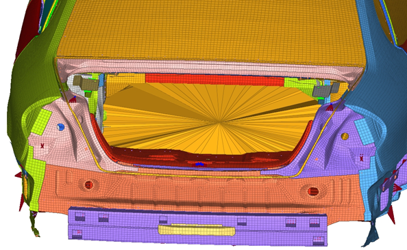

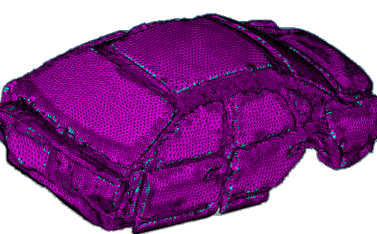

Create a Patch Manually for Separate Volumes

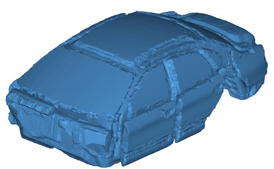

Create the Mesh

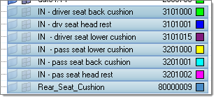

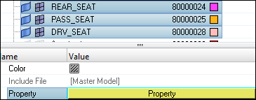

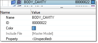

Rename the Components Created by the Acoustic Cavity Mesh
Assign the Properties to the Components
