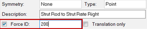

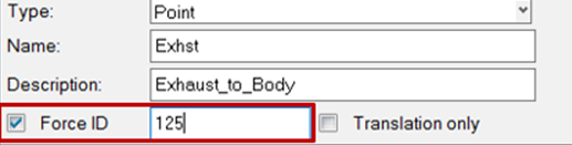

- Apply connection force ID.
- Max force Id size
- Maximum number of digits possible to be entered by you in the Force ID entry of the States tab in the Connection Browser.

Figure 2. Forcing ID's Through the Connection Mapping Tool
Figure 3. Forcing ID's Through the Connector Browser
Figure 4. Forcing ID's Through the Edit Connection Tab, Which is Opened by Right-Clicking on a Connector in the Connector Browser and Selecting Edit Connection.

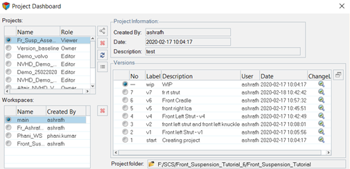

Project Workspaces:
Dashboard for Project Workspaces.

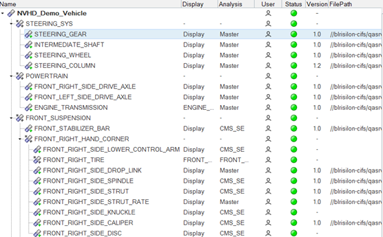

Figure 5.
Assembly Browser-Base View

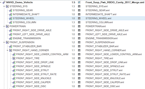

Figure 6.
Assembly Browser-File View
