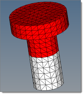

Create pretension loads in 1D and 3D bolts of ANSYS models using the ANSYS PRETS179 element type.
| Option | Description |
| 1D pretension bolt |
| 3D pretension bolt |
For 1D pretension bolts, PRETS179 elements are created at the node locations, with the pretension section created and associated to these elements. A SLOAD card with the given pretension load is also created.
For 3D pretension bolts, PRETS179 elements are created at the cut section with the pretension section created and associated to these elements. A SLOAD card with the given pretension load is also created.
