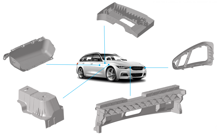

Figure 2. Direct Midmesh Supported Parts

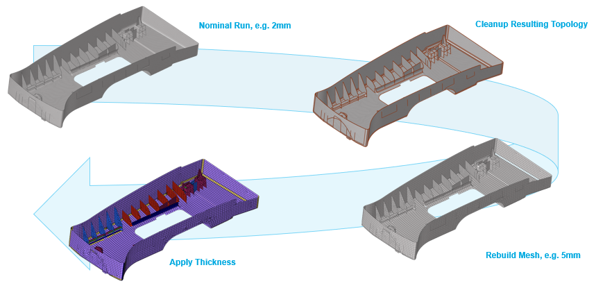

Midmesh Generation Workflow
There are several steps involved in generating a good quality midmesh. Following the workflow shown in Figure 3 helps guarantee the best result with minimal manual effort.
- Nominal Run
- Extract the base midmesh.
- Cleanup Resulting Topology
- Use the semi-automated midmesh edit edge and edit face tools to correct the 1D topology and fix any bad/missing faces. The goal is to prepare the model for final remeshing.
- Rebuild Mesh
- Remesh to the final size and quality using the rebuild mesh functionality, and correct any remaining mesh quality issues.
- Apply Thickness
- Map the thickness from the original solid to the midmesh via the Map Thickness tool.
Figure 3. Midmesh Workflow
