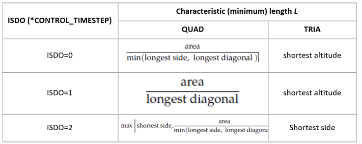

Critical Time Step for Shell (2d) Elements
Figure 3.

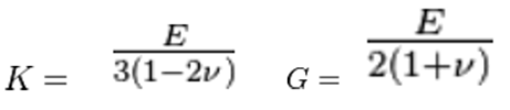

Where E is Young's modulus, ρ is Material density, 𝜐 is Poisson's ratio, K is Bulk Modulus, and G is Shear Modulus..

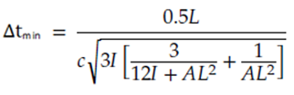

Figure 9.
Where I and A are the maximum value of the moment of inertia and area of the cross section, respectively.
