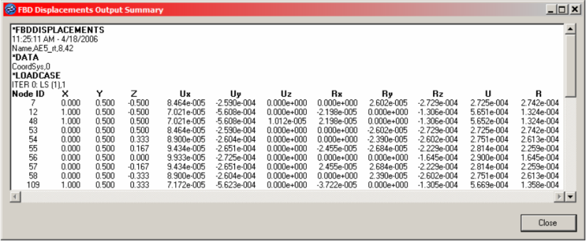

To output the results to a popup window for instant review, select the
Show summary checkbox.
The table contains information about the loadsteps, element and node set(s), and detailed displacement data at each node.
Figure 1. -
