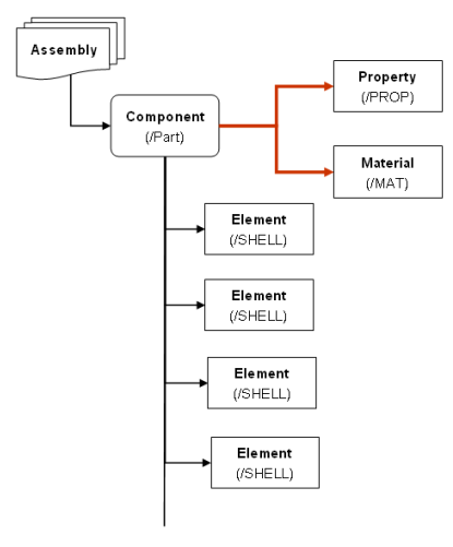

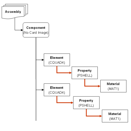

By Component Hierarchy
Figure 1. Solver Group 1. OptiStruct, Abaqus, Nastran
Figure 2. Solver Group 2. Radioss, ANSYS, LS-DYNA, PAM-CRASH, Permas
