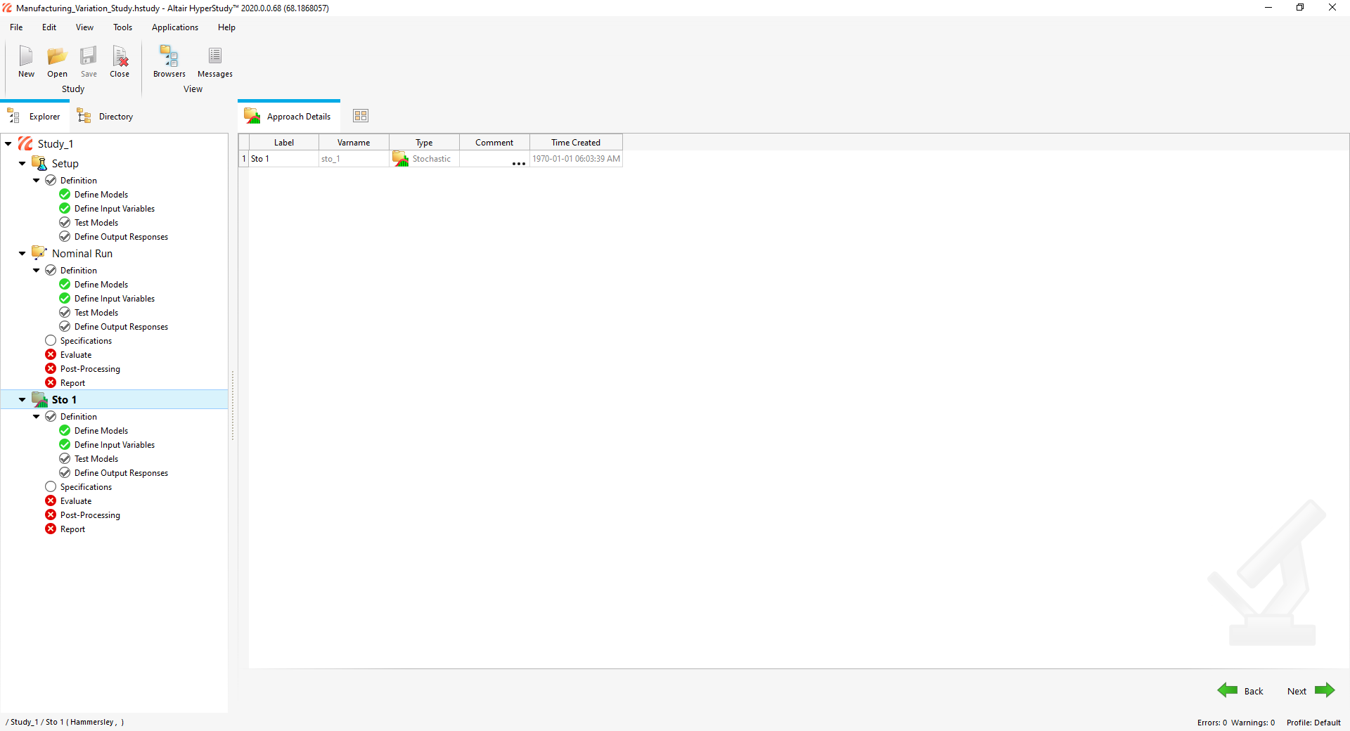

A file browser option will be displayed. Browse and select
Manufacturing_Variation_Study.xmlpresent in the SnRD Pre working directory location. -
Once the XML file is loaded, a session tree will populate in
HyperStudy and the process will start from
Sto 1 node.
Figure 1.Note: Green check boxes signify that the respective data is available. Any Yellow, Red or empty boxes mean inputs are required. -
Click Next

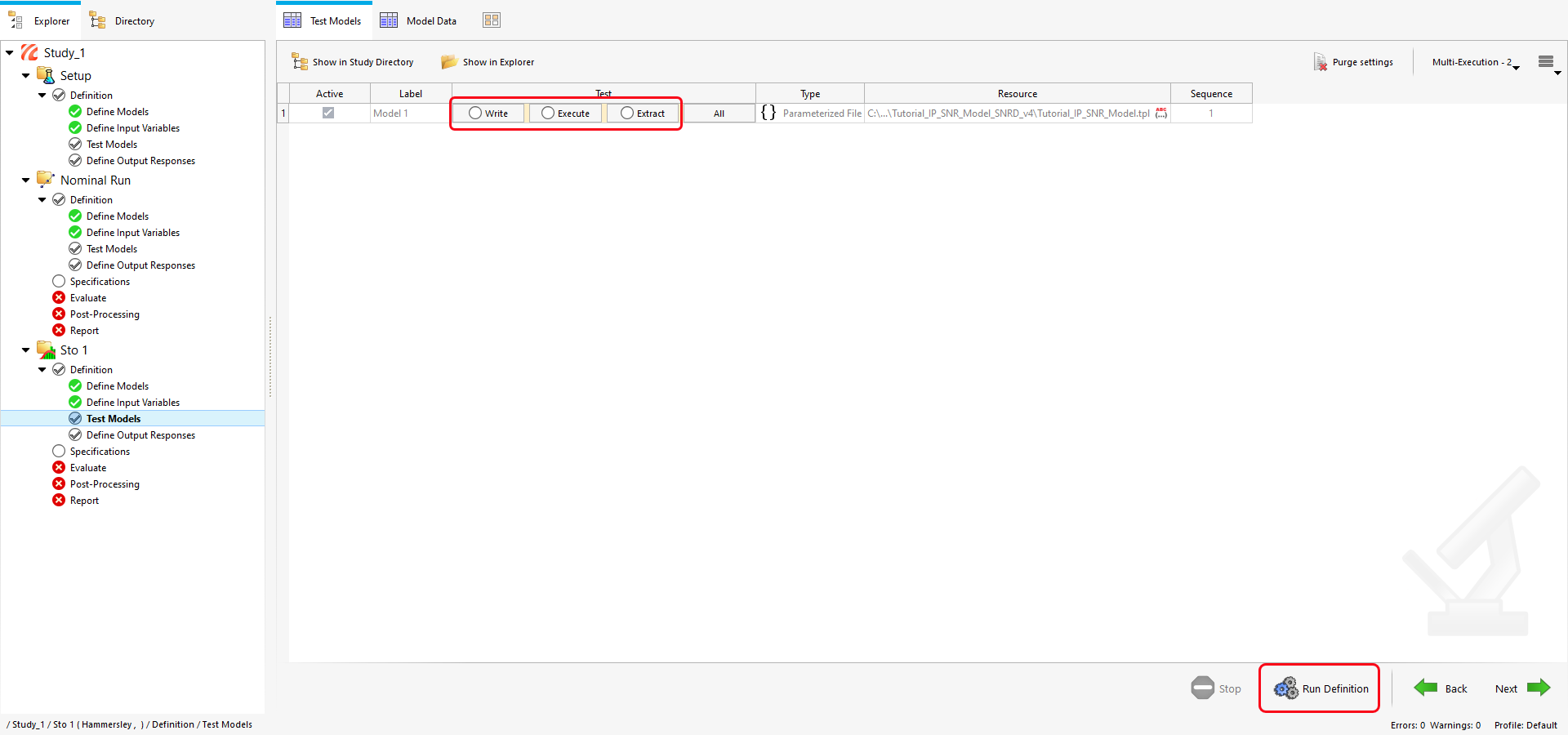

to proceed to Sto 1 > Definition > Test Models task.
Note: You can skip Define Models and Define Input Variables tasks since they are pre-defined.
Figure 2. - Click All under Test column.
Click Next
to proceed to Define Output
Responses and click Evaluate.

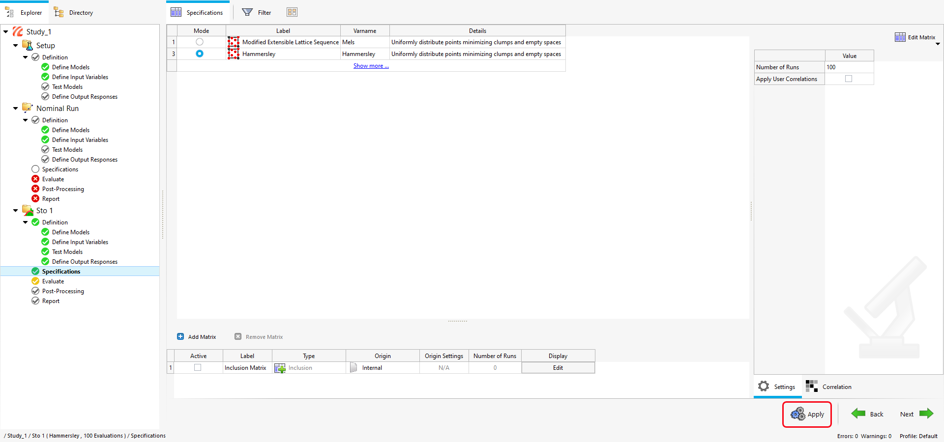

Click Next
to proceed to
Specifications and click
Apply
Figure 3. -

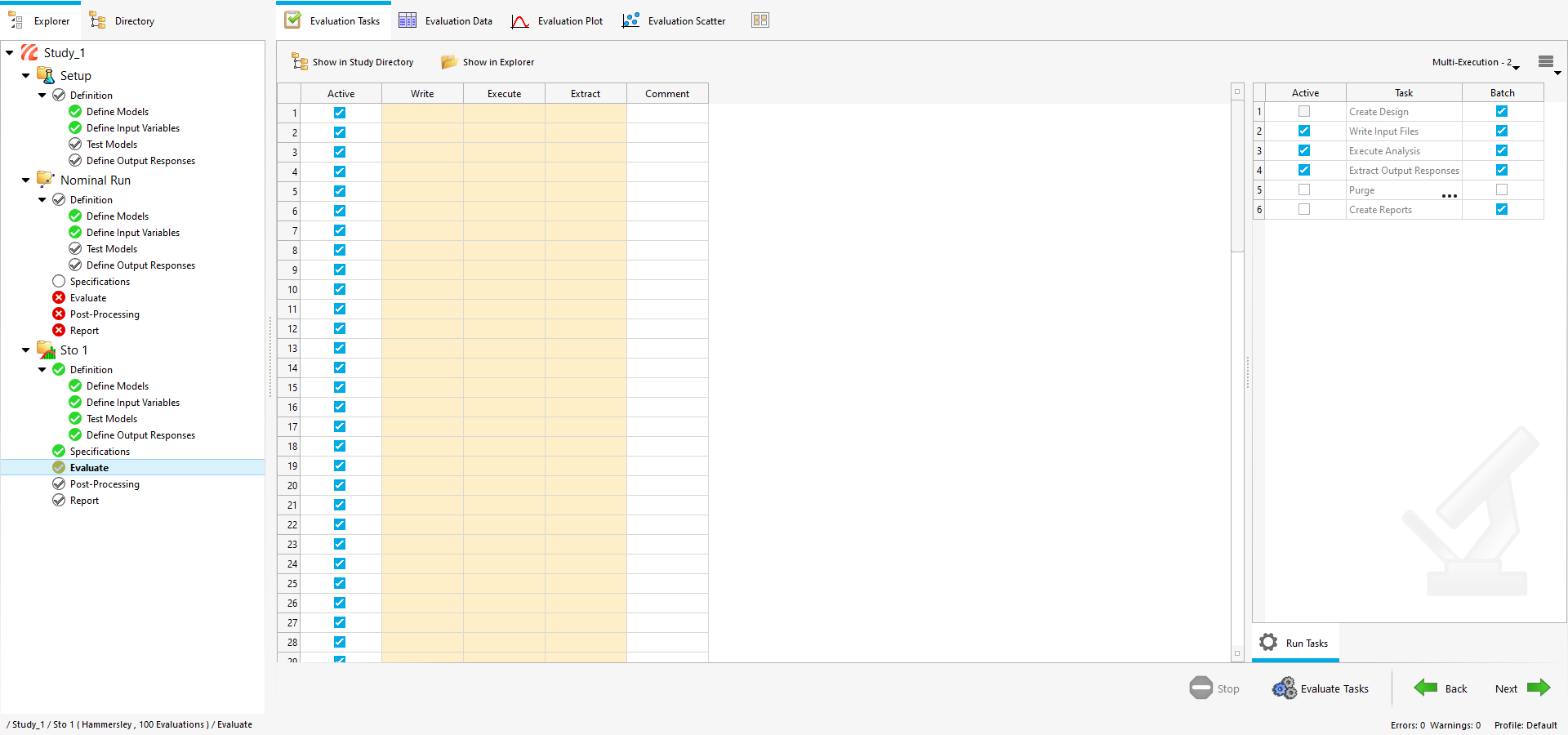

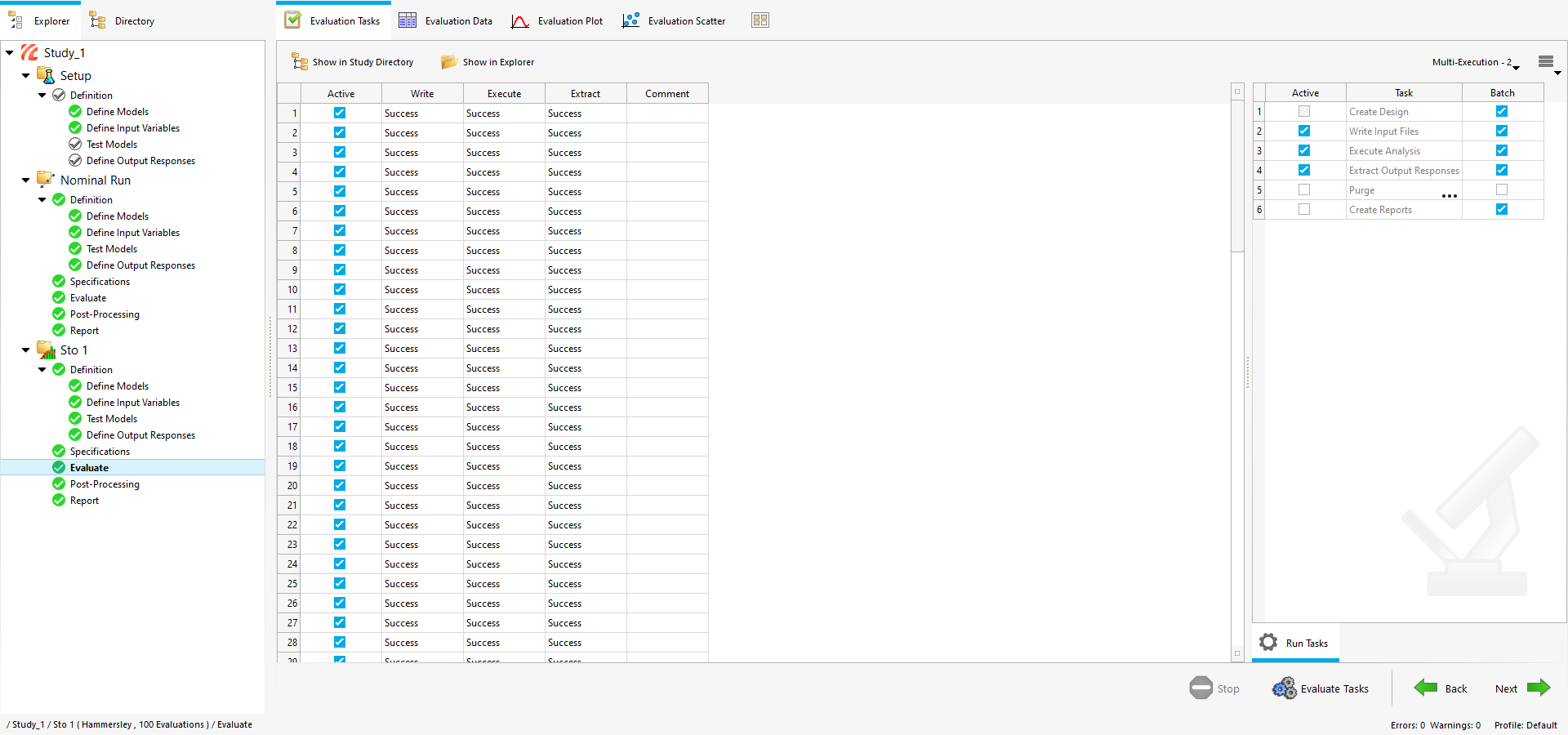

Evaluate.Click Evaluate
to run the stochastics variations.
Figure 4.Note: Evaluation tasks will take considerable amount time to complete. Please do not interfere with HST when the process is running.
Figure 5.Once the evaluation is completed, remaining tasks, I.e Post-processing and Report turn green.
