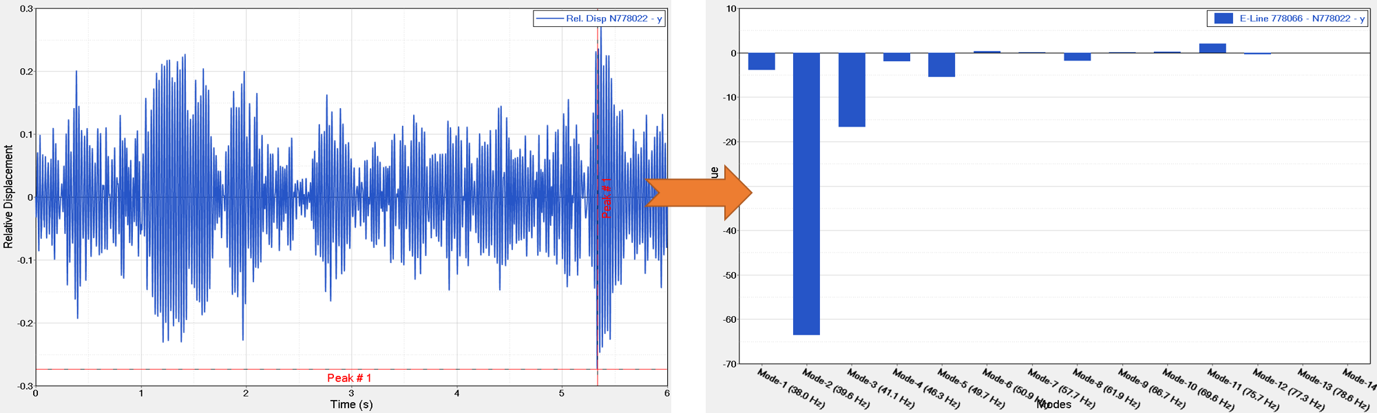

With all the above responses available in the standard outputs from OptiStruct Analysis, the Relative Modal Contribution [%] values can be calculated. These will describe the participation of a mode or modes on a peak of the time domain response.
Figure 1. - Modal Sensitivity

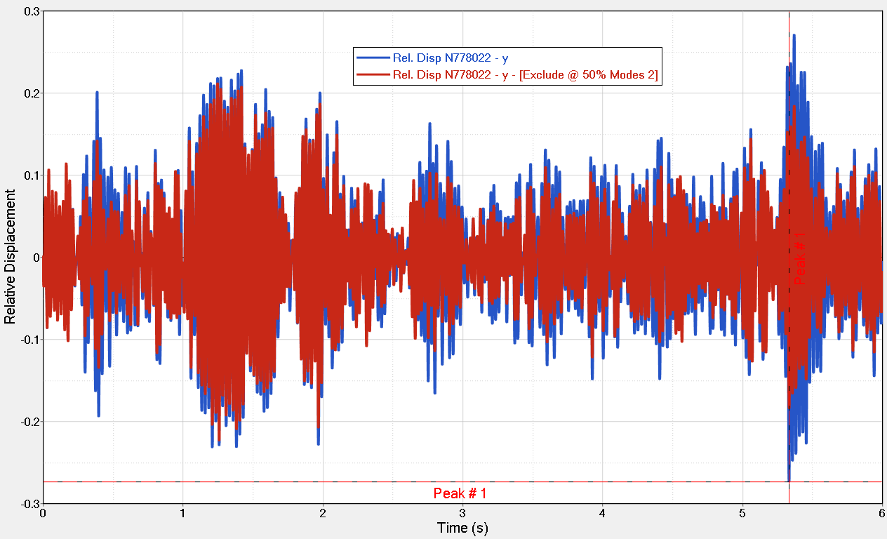

The modal sensitivity allows the analyst to live perform what-if studies by altering the time domain response of an E-Point or complete E-Line. This is achieved by decomposition of the Modal Superposition response, applying a factor (between 0 and 1) on selected modes, damping, canceling or isolating them.
