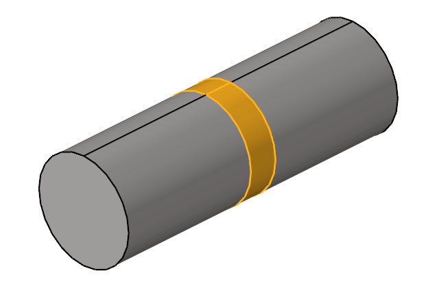

Problem Description

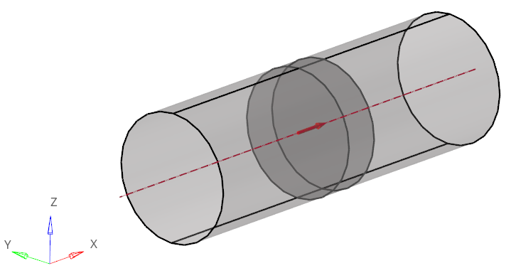

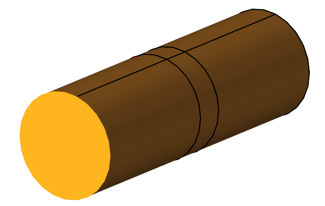

The problem to be solved in this tutorial is shown schematically in the figure below. It consists of an interior fan which rotates at a speed of 377 rad/sec (~3600 RPM) and has a thickness of 0.06 m and a tip radius of 0.11 m. The volumetric flow rate at the inlet is 0.146 m3/sec (~525.35 m3/hr). The problem is simulated as a steady state run and the pressure rise across the fan region is computed.

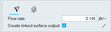

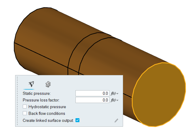

Set Up Flow

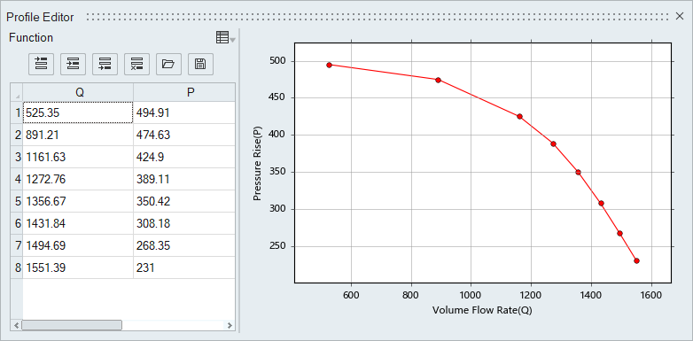

Define the Fan Component

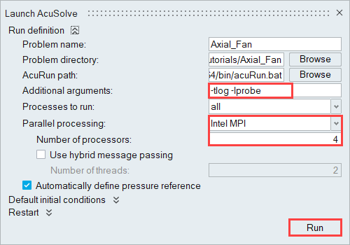

Run AcuSolve

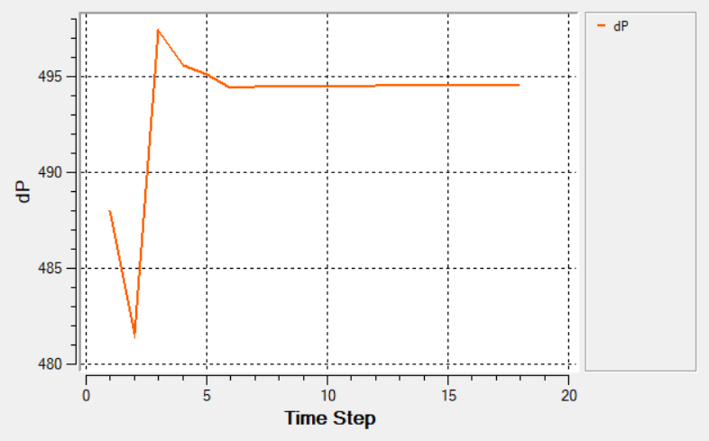

Post-Process with AcuProbe

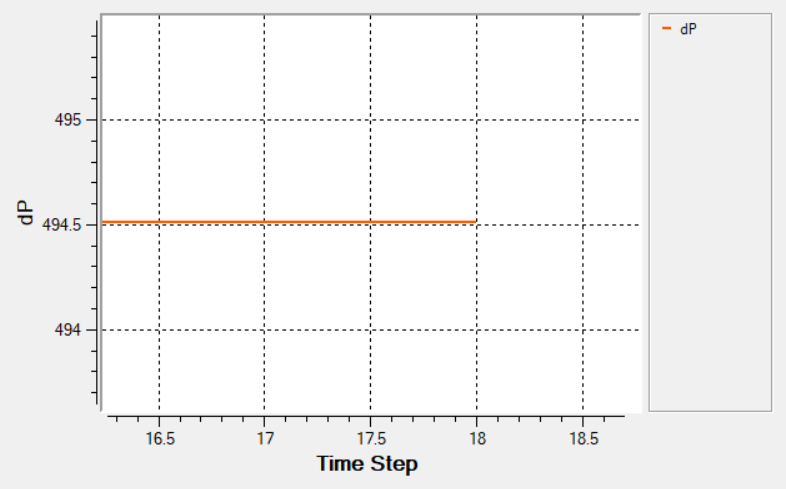

As the solution progresses, the AcuProbe window is launched automatically. AcuProbe can be used to monitor various variables over solution time.
Summary

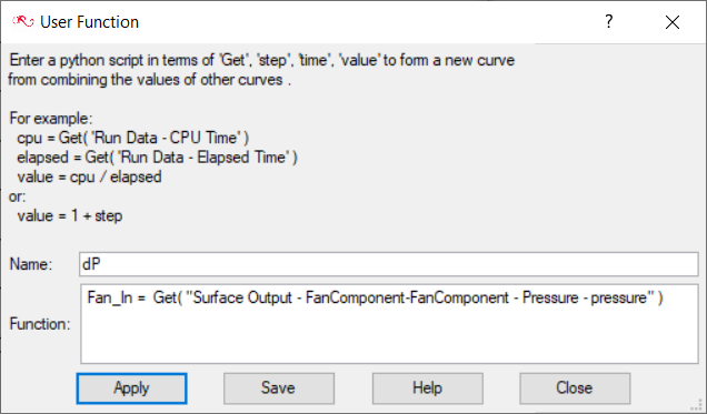

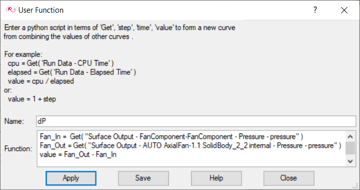

In this tutorial, you successfully learned how to set up and solve a simulation involving a fan component using HyperWorks CFD. You imported the geometry and then defined the simulation parameters, fan component, and flow boundary conditions. Once the solution was computed, you defined a user-function in AcuProbe in order to create a plot of the pressure rise across the fan volume.
