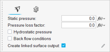

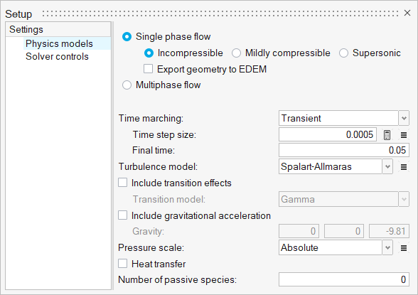

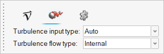

Set Up Flow

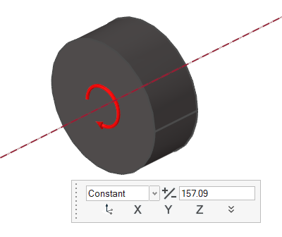

Define the Rotating Mesh Motion

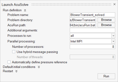

Run AcuSolve

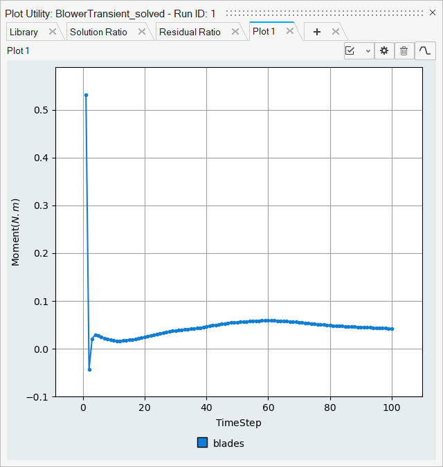

Plot Surface Output

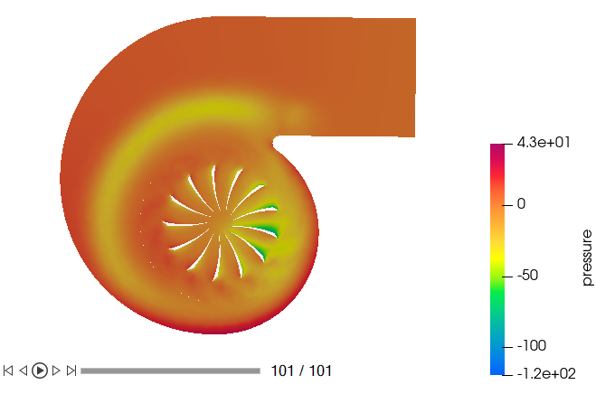

Post-Process the Results with HW-CFD Post

In this tutorial, you worked through a basic workflow to set up a transient simulation with a sliding mesh in a centrifugal blower. You started by importing the mesh; once the case was set up, you generated a solution using AcuSolve. Then, you computed the blower momentum using the Plot Utility and created a contour plot for pressure on a cut plane using HW-CFD post.
