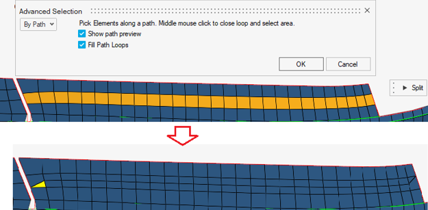

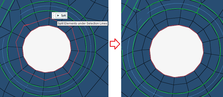

Graphical Lines - Draw continuous single or multiple graphical split lines.
- Click Split.
Figure 2.Element Selection - Select elements to split.
- Click Split.
