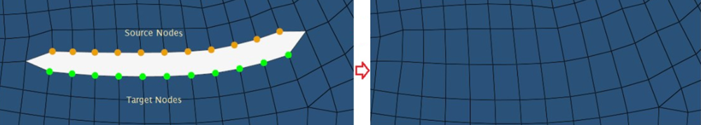

Multi to Multi (Node Pair) - Select a node to relocate and replace.
- Select a target node.
- Repeat this process as many times as desired.
- Left-click on a target node or click Replace on the guide bar to replace all nodes at once.
Multi to Multi (Node Path) - Select nodes by path to relocate and replace.
- Select target nodes by path.
