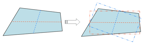

Aspect Ratio (quads)
If the element is not flat, it is projected to a plane which is based on
the average of the element’s corner normals. All subsequent calculations
are based on this projected element rather than the original (curved)
element.
Next, two lines are created which bisect opposite edges of the element.
These lines are typically not perpendicular to each other or to any of
the element edges, but they provide four midpoints.
Third, a rectangle is created for each line, such that the line
perpendicularly bisects two opposing edges of the created rectangle, and
the remaining two edges of the rectangle pass through the remaining
line’s endpoints. This creates two rectangles—one perpendicular to each
line. Figure 2. Aspect Ratio for Quads
Finally, the rectangles are compared to find the one with the greatest
length ratio of longest side to shortest side. This value is reported as
the quad’s aspect ratio. A value of 1 indicates a perfectly equilateral
element, while higher numbers indicate increasingly greater deviation
from equilateral.

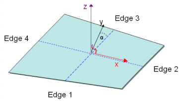

Skew (Quad)
The skew test begins by bisecting the four element edges. This creates
an origin at the vector average of the four corners, with the x-axis
extending from the origin to the bisector on edge 2. Next, finding the
cross-product of the x-axis and the vector that stretches from the
origin to the midpoint of edge 3 defines the z-axis. With the x and z
axes defined, their cross-product defines the y-axis. Figure 5. Skew for Quads
Finally, subtracting the angle α (located between the y axis and
the line bisecting edges 1 and 3) from 90 degrees reveals the element
skew.

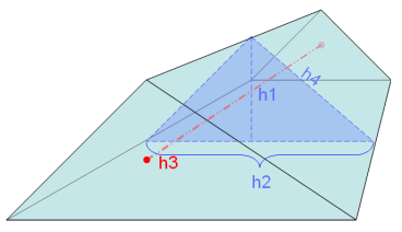

Vol. Aspect Ratio (wedge)
This test begins by averaging the triangular faces of the element to
create a triangular mid-surface. Next, it finds the aspect ratio of the
mid-surface, as for a tria element. Then it compares the average height
(h1) of the wedge element to the mid-surface’s maximum edge length
(h2). Figure 7. Vol. Aspect Ratio for Wedges
If the wedge height h1 exceeds the edge length h2, the wedge’s
aspect ratio equals the mid-surface aspect ratio multiplied by h2, then
divided by the average distance between the triangular faces (h3).
If the wedge height h1 is less than the edge length h2, the wedge aspect
ratio equals either the mid-surface aspect ratio, or the maximum edge
length h2 divided by the average distance between the triangular faces
(h3), whichever is greater.
