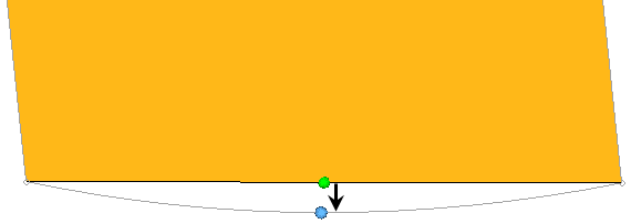

Chordal Deviation
Chordal deviation of an element is calculated as the largest distance
between the centers of element edges and the associated surface. 2nd
order elements return the same chordal deviation as 1st order, when the
corner nodes are used due to the expensive nature of the
calculations. Figure 1. Chordal Deviation
