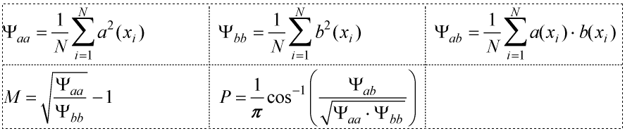

Definition
- Calculate the metric M for magnitude difference and P for phase difference
as follows:
- Calculate the combined metric C as follows:C=1 is a perfect match. Metric C is what we want to show.Note: is known as the Sprague-Geers Combined Metric.

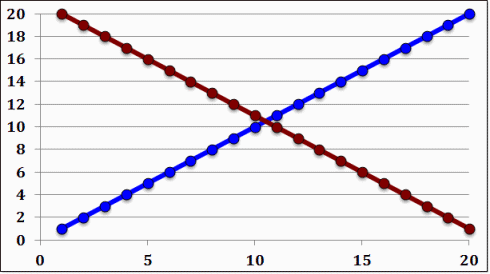

Example 1: Signals with the same overall magnitude, but drastically different slopes
Ψaa=143.50, Ψbb=143.50, Ψab=77.00, M+0.00, P=0.319714, C=0.680286

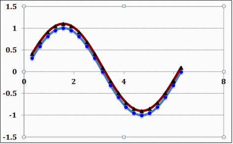

Example 2: Two very similar signals displaced in the y direction by 5%
Ψaa=0.50, Ψbb=0.51, Ψab=0.50, M=0.009852, P=0.044719, C=0.954208

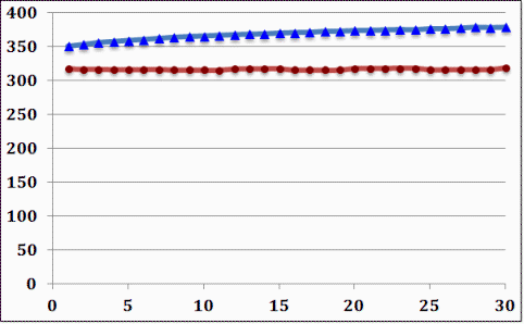

Example 3: A synthesized MIT example for Dynamic Stiffness
Figure 3.
Ψaa=3.39E+5, Ψbb=3.77E+5, Ψab=3.57E+5, M=0.051164, P=0.026831, C=0.942227

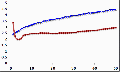

Example 4: A synthesized MIT example for Loss Angle
Figure 4.
Ψaa=1.39628E+1, Ψbb=6.67958, Ψab=9.59216, M=0.445811, P=0.037025, C=0.552654
