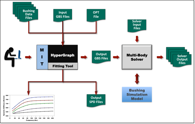

MIT and the Fitting Process
- Fitting test data from frequency- and amplitude-dependent bushings to empirical models of bushings.
- Running a simulation using fitted parameters with an empirical model.
Fitting a Bushing Model
- Input
- Fitting begins with Bushing Data files. These are Input System Property
Data files in ASCII format, also known as Input SPD files. Once you have
the required .spd files, you do three things in the
HyperWorks:
- Select a bushing model.
- Define the initial guesses of parameters for the built-in optimizer that does the fitting. The initial guesses are stored in General Bushing System files in ASCII format, known as Input SPD files.
- Specify settings in a third ASCII text file, known as the OPT file.
- Analysis
- The HyperWorks interacts with an embedded Fitting Tool, which contains models for frequency- and amplitude-dependent bushings and hydromounts. The fitting tool also includes optimization algorithms to rationally change the model coefficients to fit the experimental data.
- Once the fitting is complete and a set of model parameters is determined, the fitting tool communicates the fitted model parameters back to the HyperWorks.
- Output
- The fitting tool generates three key outputs: an output SPD file, an output GBS file and a Fit Report.
- The output .spd file contains the dynamic-stiffness and loss-angle behavior of the fitted model. The HyperWorks plots the data in the input .spd file, which contains data from the physical test, and the output .spd file, which includes the data for the analytical model behavior to help you gauge the quality of the fit.
- The output .gbs file contains the fitted model parameters. This file can be used in a downstream simulation.
- The Fit Report is a PDF that contains a summary of the fit process.
Simulations
- Modeling
- Create your model using a multibody pre-processor such as MotionView. MotionView includes a comprehensive user interface for instantiating frequency- and amplitude-dependent bushings. Within MotionView, you can create a full vehicle model, and then run an analysis using MotionSolve.
- Analysis
- Perform an analysis using a multibody solver such as MotionSolve.
- Output
- The analysis of the model generates various solver output files. You can review these files with post-processors such as HyperGraph and HyperView to understand the behavior of the model.
