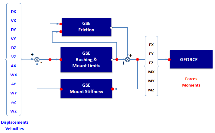

- Altair Bushing Model in a MotionSolve Model
- The Altair Bushing Model is complex and relies
on a number of atomic solver elements to represent the individual effects
described earlier in this guide. The figure below illustrates these elements
and the data flow between them as they exist in a single Altair Bushing Model within a MotionSolve model.
Figure 1. - Components of a Bushing Model
- The following sections describe the components shown above in more detail:
- Data Blocks
- The blocks in the simulation model include:
Block Description GSE-Friction (Control_StateEqn) Computes the friction moment. The friction acts in response to rotational motions of the I-Body relative to the J-Body. GSE-Bushing (Control_StateEqn) Computes the bushing forces and moments and the time derivatives of states associated with the bushing forces and moments. This modeling entity also includes the forces and moments due to the bushing reaching the limits of its travel. This may include material contact between the I-Body and J-Body. GSE-MountLimits (Control_StateEqn) Computes the local structural deflection and rate of change of deflection given the sum of the friction, bushing, and limit forces and moments acting between the I-Body and J-Body. GFO FORCE (Force_Vector_TwoBody) Applies the net bushing forces and moments to the I-Body and J-Body. For examples of blocks in the .gbs file, see: Bushing Property File. Bushing design data is passed in through a combination of files and solver REFERENCE_ARRAYs and String objects.
