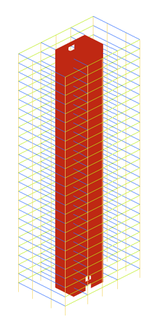

Figure 1. FE Model
Model Description
- Objective
- Minimize the mass
- Constrains
- Response Spectrum Displacement Constrain (RSDISP)
- Design Variables
- Shape Design Variables
- Reference Guide Entries
- DESOBJ, DESVAR, RSDISP, DCONSTR, DCONADD, RSPEC

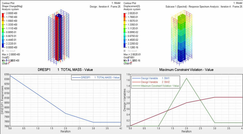

Results
Figure 2. Final Design Change
