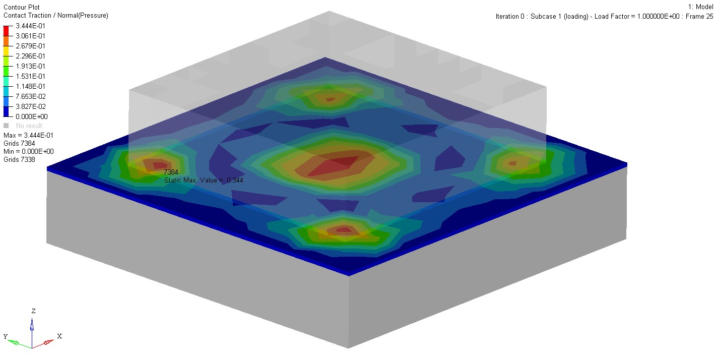

Figure 1. Contact Force Distribution at Iteration 0 and Load Factor 1.00

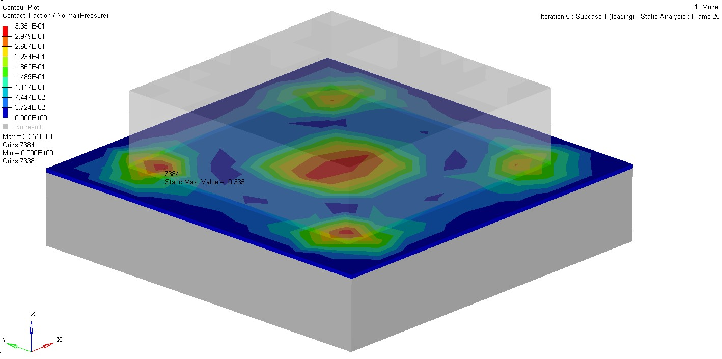

Figure 2. Contact Force Distribution at Iteration 5
The converged optimized model, the weight has reduced weight from 2.37635 E-3 to 2.37585 E-3 tons and the contact pressure is reduced from 0.3444 MPa to 0.3351 MPa.
