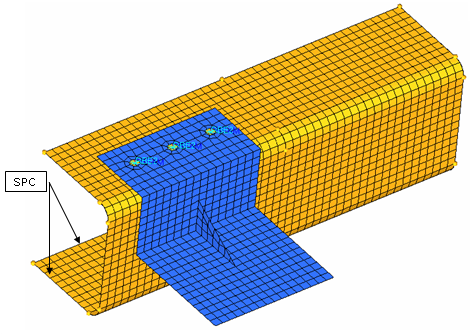

OS-T: 1110 Modal Analysis Setup
In this tutorial, you continue to gain an understanding of the basic concepts for creating a OptiStruct input file. More specifically, learn how to set up a model for modal analysis, specify solver specific controls and also submit an input file to the solver from HyperMesh.
The channel_brkt_modal.hm file is used for this tutorial. It contains the bracket and channel assembly pictured below.
To complete the setup of the model for a modal analysis with OptiStruct, you need to define a normal modes SUBCASE, containing METHOD and SPC statements.
rd1110-01

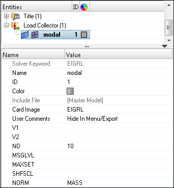

Create Load Collectors
  1. In the Model Browser, right-click and select Create > Load Collector from the context menu.
    A default load collector displays in the Entity Editor.
  2. For Name, enter modal.
  3. Click Color and select a color from the color palette.
  4. Set Card Image to EIGRL.
  5. For ND, enter 10.
    ND specifies the number of modes to extract.
    os_1110_13_01

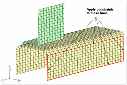

    You are going to create the SPC constraints on the nodes along the lines on the perimeter of the channel's bottom surface, as shown in the image below.
    rd1110-02
    Figure 3. Apply Constraints on the Channel
  4. Click BCs > Create > Constraints to open the Constraints panel.
  5. Switch the entity selector to lines.
  6. Select the six lines on the perimeter of the channel's bottom surface.
    To view the selected lines clearly, switch to Transparent Elements mode, as shown below:
    rd1110_transparent
    Figure 4.
