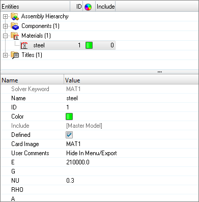

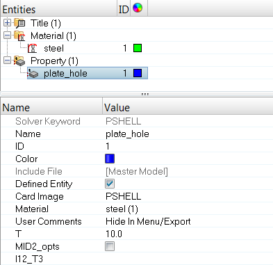

Create the Material

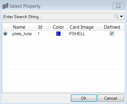

Create the Property
Update the plate_hole Component

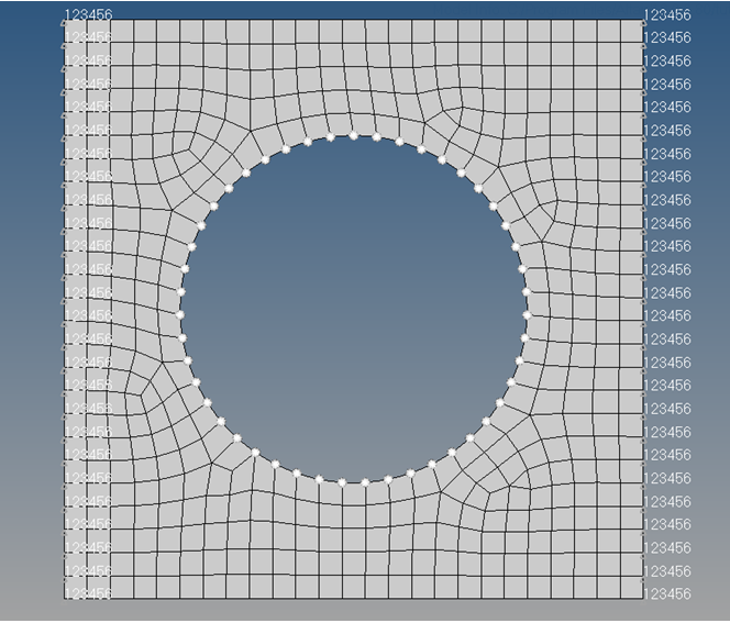

Apply Loads and Boundary Conditions

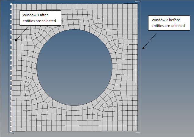

In the following steps, the model is constrained so that two opposing edges of the four external edges cannot move. The other two edges remain unconstrained. A total load of 1000N is applied at the edge of the hole in the positive z-direction.

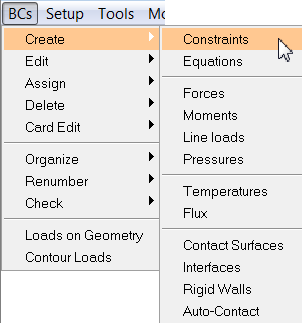

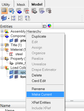

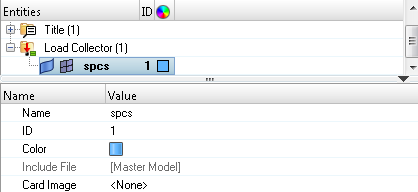

Create Load Collectors

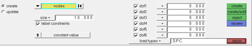

Create Constraints

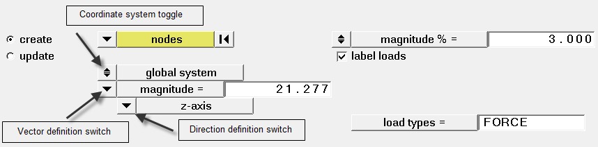

Create Forces on the Nodes around the Hole

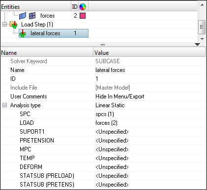

Create Load Steps
An OptiStruct subcase has been created which references the constraints in the load collector spcs and the forces in the load collector forces.
Figure 13. Creating the lateral forces Loadstep

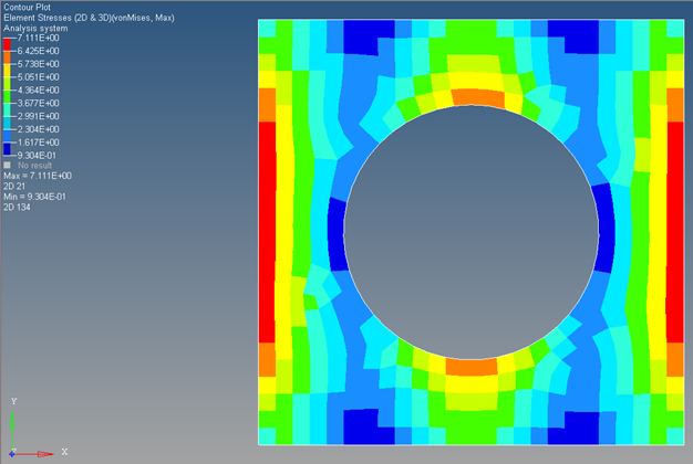

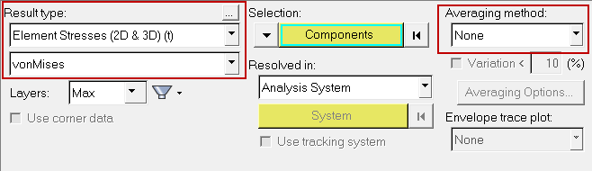

View a Contour Plot of Stresses
- What is the maximum von Mises stress value?
- At what location does the model have its maximum stress?
- Does this make sense based on the boundary conditions applied to the model?

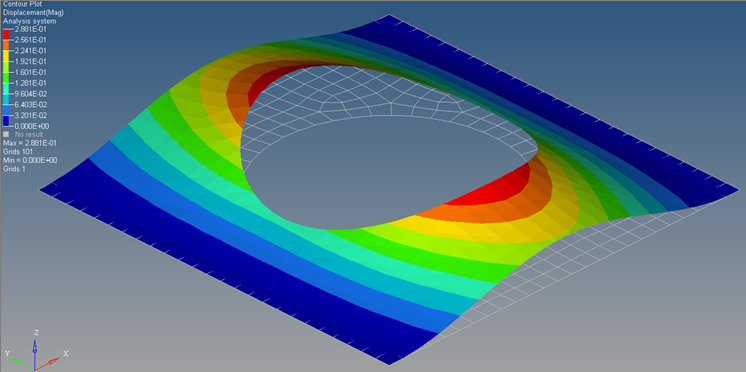

View a Contour Plot of Displacements
- Under Result type set the first first pull-down menu to Displacement (v) and set the second pull-down menu to Mag.
- Click Apply.
- What is the maximum Displacement value?
- At what location does the model have its maximum displacement?
