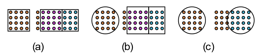

Figure 1. . Extensions and removal regions for different outlet region types. Particles are color coded as brown for regular particles, purple when they are affected by the extension, and as cyan when residing in removal region. The particle distribution shown in the extension is merely a suggestion and the actual distribution depends on the simulation. Additionally, the removal region will be completely devoid of particles in a real simulation. Continuous lines show extension and removal region borders. (a) Cuboid outlet region (removal and extension). (b) Cylinder outlet region (removal and extension). (c) Sphere outlet region (removal only).

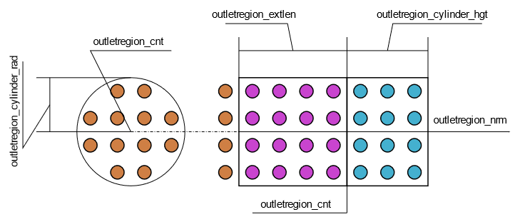

Figure 2. . Cylinder outlet region definitions, color coded as Figure 2. The particle distribution shown is hypothetical.

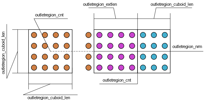

Figure 3. .
Cuboid outlet region definitions, color coded as Figure 2. The particle distribution shown is hypothetical. Since outlet region normal is defined, the center lies at the interface between extension and removal regions.

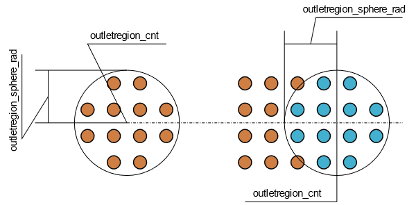

Figure 4. . Sphere outlet region definitions, color coded as Figure 2. The particle distribution shown is hypothetical.
