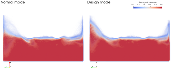

Figure 1. Time-Averaged Oil Distribution for 2-Gear FZG Case (No Gears Shown). DESIGN mode is enabled for the image on the right, and NORMAL (default) mode is enabled for the image on the left. Both simulations were single phase. Run time of the NORMAL mode is 4h 33min, while the DESIGN mode ran in 59min (4.5x speed up).

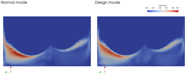

Figure 2. Time-Averaged Velocity Magnitude for 2-Gear FZG Case (No Gears Shown). DESIGN mode is enabled for the image on the right, and NORMAL (default) mode is enabled for the image on the left. Both simulations were single phase. Run time of the NORMAL mode is 4h 33min, while the DESIGN mode ran in 59min (4.5x speed up).
As can be seen in Figure 1 and Figure 2, the differences caused by numerical changes in the code are not substantial, though again, depending on the purpose of the simulation, one might argue otherwise. Another important consideration is that this example case was run in single phase only, and that including the air phase in the normal mode would most likely immediately increase the run time by a factor of 2. This would bring run time comparison to 9h versus 59min, which is obviously a 9x speed up. What you have to ask yourself is: do you want or need to include multiphase flow phenomena, such as aeration or windage effects?
