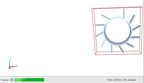

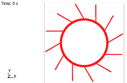

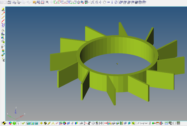

- The problem consists of a wheel, that can only rotate around its center. A number of particles is impinged on the wheel blades, causing it to rotate. The wheel is modeled in MotionSolve, while the particles and its interaction with the wheel is modeled in EDEM. A rigid Wheel to particle interaction is set up first. The wheel is later replaced with a flexible body to show flexible body to particle interaction.

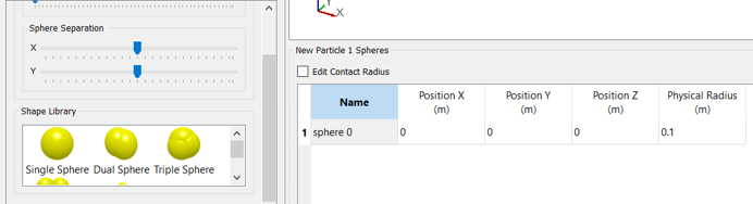

- Define a particle shape

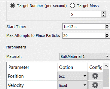

- Define a virtual geometry/particle factory

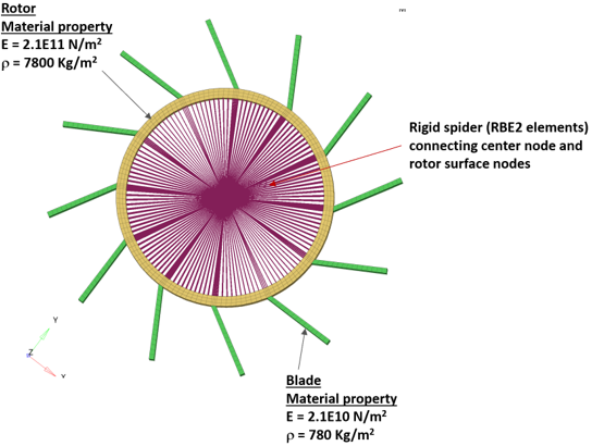

Flexible Body Coupling
An equivalent flexible body H3D file of the wheel is available.
