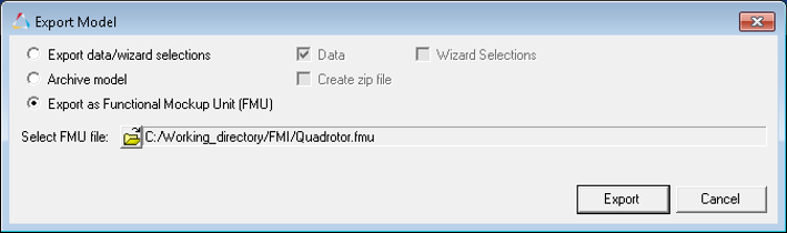

- Export an FMU from MotionView

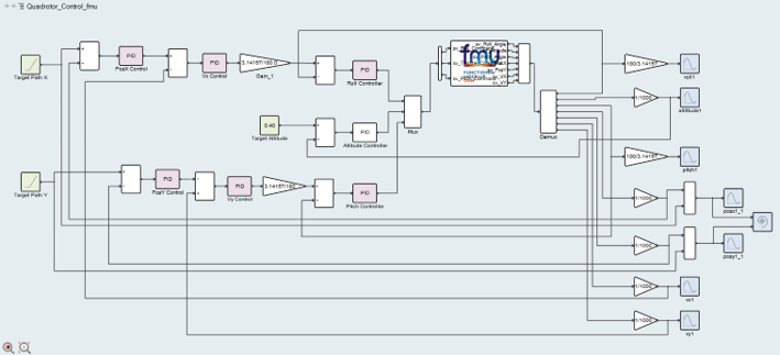

A model representing a quad-rotorcraft is used for this tutorial. The model structure, rotor blades etc. are modeled using MotionView/MotionSolve and Activate is used to control the spin rate of the rotors to control the thrust and lateral movement of the rotor. Roll forces are applied to the rotorcraft to mimic the effect of wind. The aim of the simulation is to control the thrust to make the rotor achieve a target height.

Export MDL as an FMU

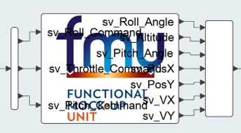

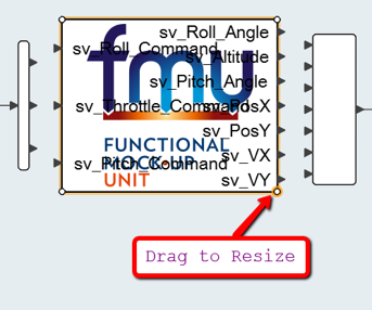

Import the FMU in Activate
Run the Activate Model

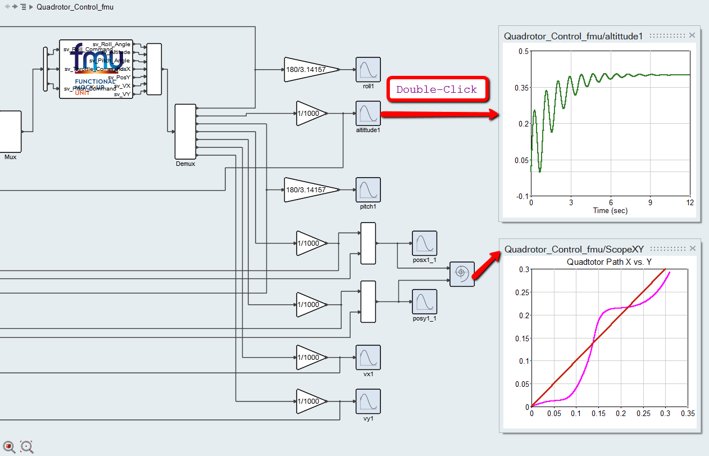

Review the Results
Figure 12.
The altittude1 scope shows the altitude of the rotor craft. After about 8 seconds, the quadrotor seems to stabilize at the desired height.
The ScopeXY scope shows the target X, Y path (red) vs. the actual X, Y path (pink) of the quadrotor.
You can retrieve results from the MotionSolve output files like the MRF, ABF, PLT, H3D etc. You may also create expressions in your MotionSolve model that are used solely to monitor the system.
