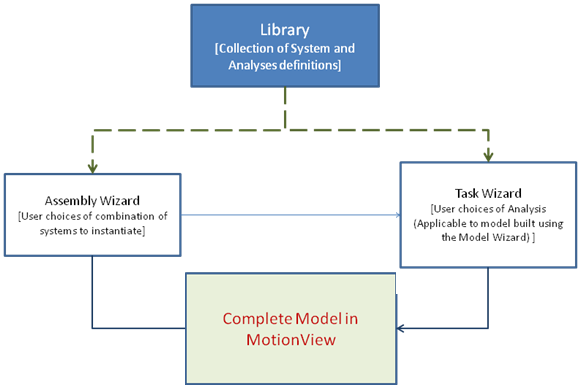

- A collection of systems and analyses are stored as a library.
- The Assembly Wizard presents the user with various options for selecting systems to instantiate (in the form of a series of panels).
- The systems selected by the user in the panels are instantiated using the system definitions contained in the MotionView client library, thereby assembling the model comprised of different systems. An Attachment Wizard is used to select possible attachment options for each instantiated system.
- Once the model is built, the Task Wizard is invoked in order to attach applicable events to the model. The selected analysis is instantiated using the analysis definition stored in the library.

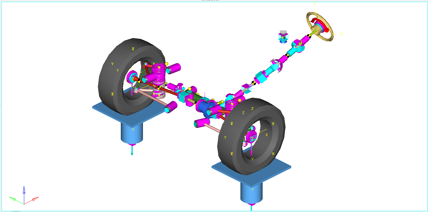

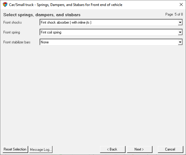

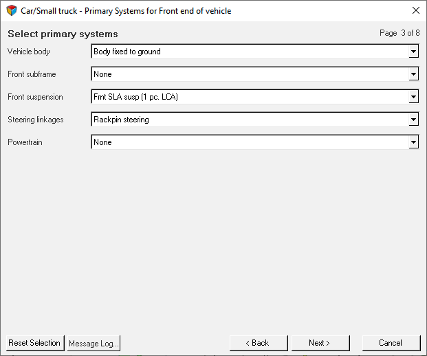

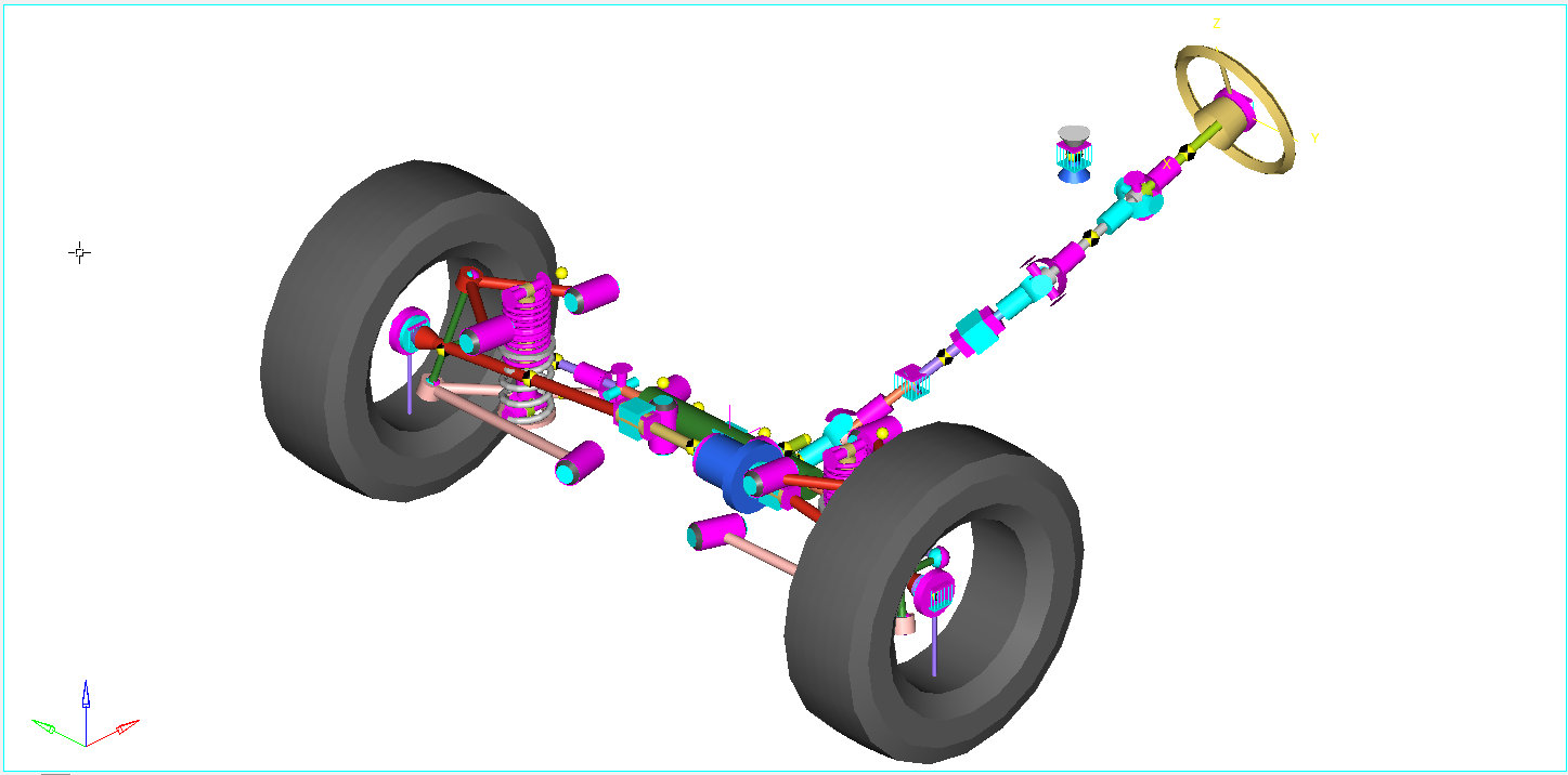

Build a Front Suspension Model using Assembly Wizard
In this exercise, you will build a suspension model of a vehicle using the standard wizard library available in MotionView.

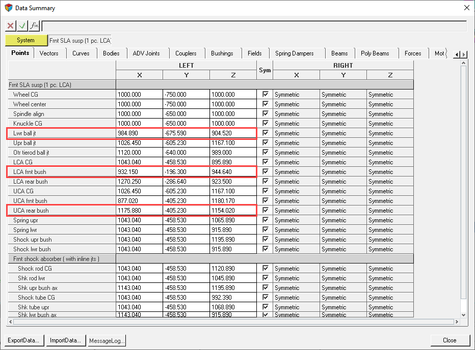

Modify the Model Parameters
In this step you will modify the suspension parameters and re-run the simulation.

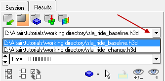

Compare Results
In this step, you will compare the reports for both suspension simulations.
