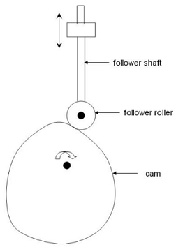

MV-1026: Model Curve-to-Curve (CVCV) Higher-Pair Constraint
In this tutorial, you will learn how to model a CVCV (curve-to-curve) joint.

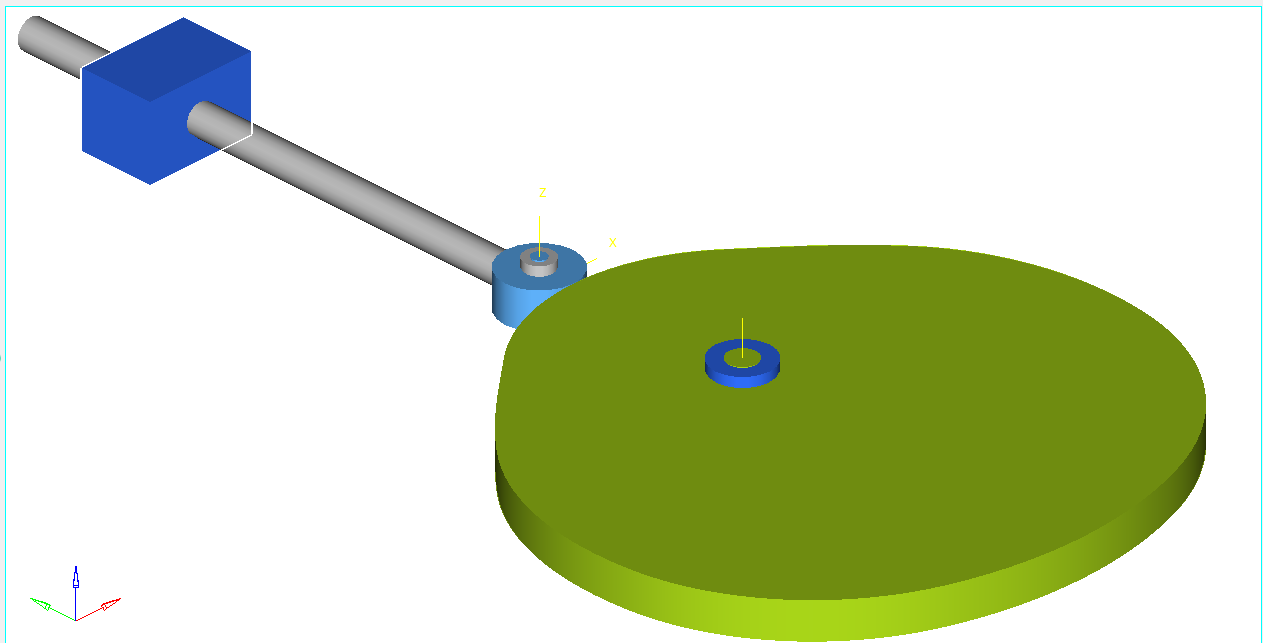

Create Graphics
In this step you will create graphics for the bodies and joints in the cam-follower model.

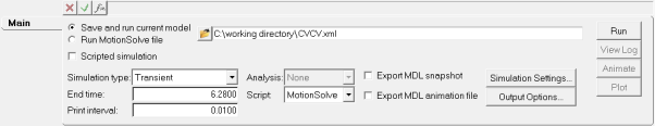

Run the Model
In this step you will run the cam-follower model.

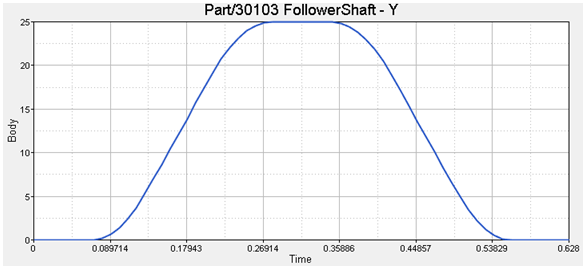

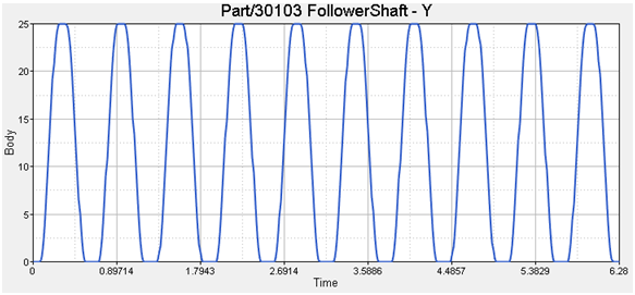

View the Results
In this step you will learn how to view the animation and plot the Y displacement of the follower.

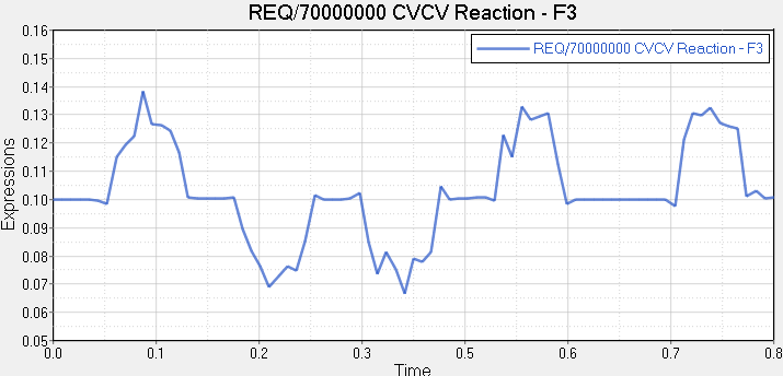

Check the Model for Potential Lift-Off
In this step, you will check the cam-follower mechanism for potential lift-off by plotting the Y profile of the CVCV reaction on the follower roller.
