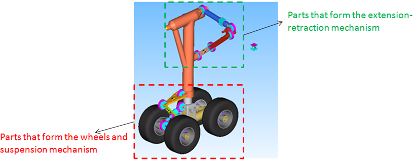

In this exercise, a landing gear mechanism is simulated for its extension and retraction. A sequence of simulations need to be scripted such that the mechanism is retracted within a certain period of time at which the simulation is halted, the model configuration is changed for retraction and the solution is executed again for extension.
Figure 1. Main Landing Gear of an Aircraft

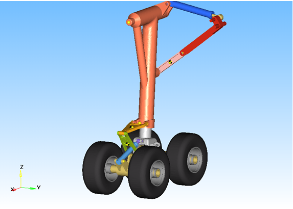

In this phase, you will prepare the landing gear model to simulate the retraction of the landing gear.

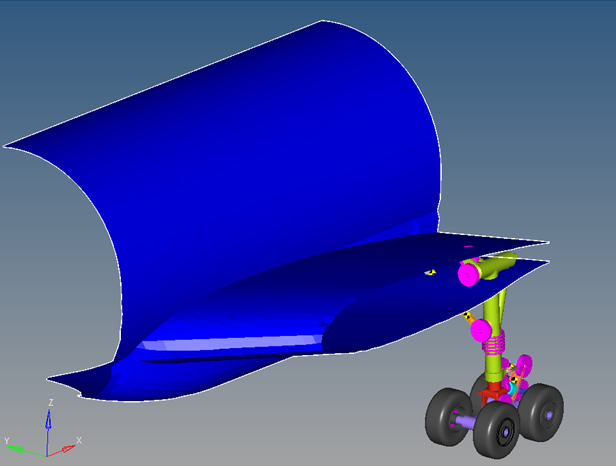

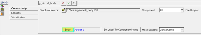

In this step, you will open a landing gear model and attach a graphic for the aircraft body.
Use a HyperMesh file to create a graphic for the aircraft body.

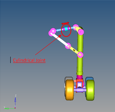

In this step, define the motion to retract the landing gear.
