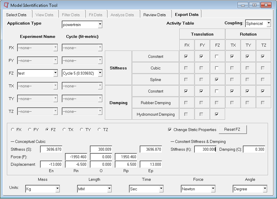

The five main functions of this tab include:
Experiment Selection
- A table on the Export Data tab lets you select a subset of reviewed data for creating a bushing. You can export only one bushing at a time.
- A bushing is identified by its Application_Type attribute in the
.spdfile. All experiments in the Review tab with the matching Application_Type are populated in the top left table. If the Application_Type field is left blank, all data in the Review tab is loaded. - The average of the Dynamic Stiffness fit score and Loss Angle fit score is displayed in parenthesis. You can use these scores to gauge the quality of the fit. The Application_Type for an Analyze operation is always blank.
- Data in the experiment selection table is preloaded to minimize user interaction. Cells that have only one value are non-editable. When only one experiment and one cycle are loaded in the Review tab, all cells are non-editable.
Activity Table
The Activity Table defines the bushing stiffness and damping options that are active in the .gbs file. The table opens with default values loaded, which you can modify.
- You can select only a single stiffness and a single damping model for each direction.
- Models are grayed out when they are not valid for a certain direction.
Static Properties
- Representation of Static Data
- MIT supports three equivalent but alternate representation for static data:
- Spline Data
- This is the data obtained from the static testing of the physical bushing. This data is copied from the input .spd file.
- Conceptual Cubic
- This is a cubic polynomial, based on the physical data that approximates the spline data. For more details, see: View Data.
- Constant Stiffness
- This value represents a linear fit to the spline data. For more details, see: View Data.
- Static Properties
- You can edit static data after selecting the Change Static Properties box.
You can specify the data to be exported by selecting the radio buttons for
any given direction.
- Conceptual Cubic
- This data is calculated from the static data in the .spd
file.Note: If no .spd file is available when the ANALYZE process is performed, then the conceptual cubic fields are non-editable and are excluded from the output .gbs file.
- Constant Stiffness and Damping
- The default is 0.0 when no experiment or .spd field is available in a certain direction.
- Constant Damping
- The default is assumed to be 0.1% of the Constant Stiffness.
- Resetting Parameters
- The Reset button lets you revert back any changes to the values of the static parameters to the original values.
Output Units
| Mass | Length | Time | Force | Angle |
| Kilogram | Millimeter | Second | Newton | Degrees |
| Gram | Meter | KiloNewton | Radians |
