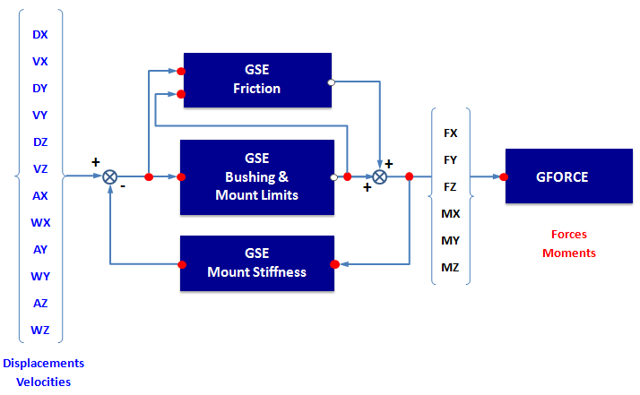

Solver Components Workflow
Below is an illustration of the various solver components and the data flow between them. Following the illustration are the required statements for a bushing model along with an example of a simple model:
GFORCE Bushing
