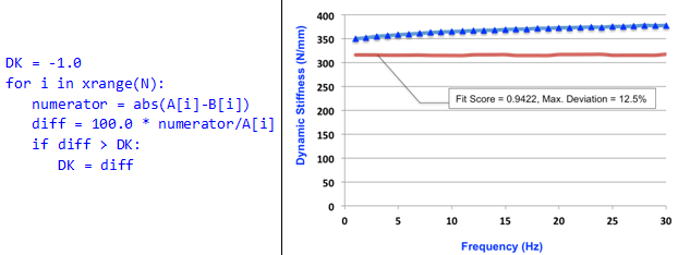

- The deviation metric for dynamic stiffness is simply the maximum deviation between two sets of dynamic stiffness curves, A(xk) and B(xk), expressed as a percentage.

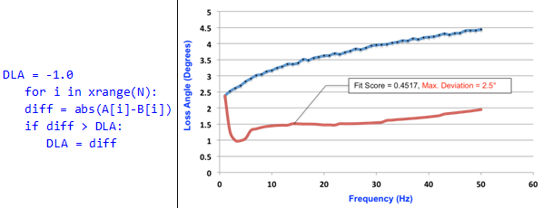

- The deviation metric for loss angle is the absolute value of the maximum absolute deviation between two sets of loss angle curves, A(xk) and B(xk), expressed in degrees

| Dynamic Stiffness | Let A(xk), k=0…N-1 be a set of data points measured
experimentally. Let B(xk), k=0…N-1 be the corresponding set of data points from the analytical model. Let the
deviation metric for Dynamic Stiffness be DK. The
pseudo-code for calculating DK is:
| Loss Angle | Let A(xk), k=0…N-1 be a set of data points measured
deviation metric for Dynamic Stiffness be DLA.
The pseudocode for calculating DLA is:
